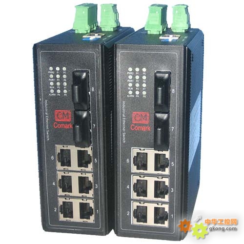

²úÆ·Ãû³Æ£º ǧÕ×10¿ÚÍø¹ÜÐÍÒÔÌ«Íø½»»»»ú
ÐÍ ºÅ£º CK7080
¸ÅÊö£º
Ck-if620Ϊһ¼´²å¼´ÓÃÍø¹ÜÐÍÈßÓàÒÔÌ«Íø½»»»»ú£¬Ö§³Ö6·10/100Base-T£¨X£©ºÍ2·100Base-FX½Ó¿Ú£¬¹âÏ˶˿ÚÓÃÓÚ×齨ÒÔÌ«ÍøÍøÂç»·ÍøÈßÓࣨ×ÔÓúʱ¼ä<20ms£©£¬´Ó¶øÔö¼ÓÍøÂçµÄ¿É¿¿ÐÔ¡£
´ËÍ⣬Ck-if620¹¤ÒµÒÔÌ«Íø½»»»»ú»¹Ö§³Ö¶àÖÖÖÇÄÜ»¯µÄÍøÂç¹ÜÀí¹¦ÄÜ£¬°üÀ¨QoS£¬VLAN£¬Port Trunking,ËÙÂÊÅäÖ㬸澯ʹÄܵȹ¦ÄÜ¡£ÎªÁËÂú×㲻ͬ¹¤Òµ»·¾³ÏµÄÓ¦ÓÃÐèÇó£¬Ck-if620½»»»»úÌṩÊÊÓ¦ÓÚ¼«¶Ëζȣ¨-40¡«85¡æ£©µÄ¿íÎÂÐͺš£
ÌØµã£º
l        ÎÞÖ÷Õ¾½á¹¹Éè¼Æ£¬¼òµ¥Ò×ÓÃ
l          6·100Base-T(X)½Ó¿Ú£¬2·1000Base-FX½Ó¿Ú
l         ¹â¿ÚÖ§³Ö»·ÍøÈßÓ࣬×ÔÓúʱ¼ä£¼20ms
l          Ö§³Ö»ùÓڶ˿ڵÄVLAN£¬IEEE802.1Q VLAN
l          Ö§³ÖQoS-IEEE802.1p/1Q
l          Ö§³Ö¾²Ì¬¶à²¥¹ýÂ˼°Port Trunking
l          Ö§³Ö¶Ë¿Ú¾µÏñ
l          ÌṩÓÃÓÚ´ø¿í¹ÜÀíµÄËÙÂÊÏÞÖÆ¹¦Äܺ͹㲥·ç±©±£»¤¹¦ÄÜ
l          Ö§³Ö8K MACµØÖ·±í
l          Ö§³Ö2·±¨¾¯ÊäÈëI/O¿Ú£¬1·±¨¾¯Êä³öI/O¿Ú
l          ÎÞ·çÉÈÉè¼Æ
l          Õý³£Î¶ȣ¨-0¡«70¡æ£©£¬À©Õ¹¿íÎÂÐͺţ¨-40¡«85¡æ£©
¹æ¸ñ£º
µç½Ó¿Ú
1.          6¸öRJ45µç½Ó¿Ú
2.          10Base-T/100Base-TX×ÔÊÊÓ¦
3.          ȫ˫¹¤/°ëË«¹¤×ÔÊÊÓ¦»òÇ¿ÖÆ¹¤×÷ģʽ
4.          Ö§³ÖMDI/MDI-XÁ¬½Ó
5.          1000Vµç´Å¸ôÀë±£»¤
¹â½Ó¿Ú
1.          2¸ö100Base-FX¹â½Ó¿Ú£¬Ö§³ÖÈßÓà»·Íø
2.          SC/ST/FC½Ó¿Ú¿ÉÑ¡
3.          Ö§³Öµ¥Ä££¨20/40/60/80Km¿ÉÑ¡£©¡¢¶àÄ£(2/5Km¿ÉÑ¡)¹âÏË£¬²¨³¤Îª1310nm
Íø¹Ü¿Ú
1.          RS-232 (RJ45)
ÆäËûÖ¸±ê
1.          ±ê×¼£º<IEEE802.3£¬802.3u£¬802.3x£¬802.1D£¬802.1W£¬802.1Q£¬802.1p£¬802.1X£¬802.3ad£¬802.3z¡£
2.          ЭÒ飺<IGMP V1/ V2/ V3 device£¬GMRP£¬GVRP£¬SNMP V1/V2c/V3£¬DHCP·þÎñÆ÷/¿Í»§¶ËDHCP Option 82£¬BootP£¬TFTP£¬SNTP£¬SMTP£¬RARP£¬RMONºÍEDS-SNMP OPC Server Pro (¿ÉÑ¡)
3.          MIB£º<MIB-II£¬Ethernet-Like MIB£¬P-BRIDGE MIB£¬Q-BRIDGE MIB£¬Bridge MIB£¬RSTP MIB£¬RMON MIB Group 1£¬2.3£¬9
4.          Á÷¿Ø£º<IEEE802.3x Á÷Á¿¿ØÖÆ£¬±³Ñ¹Ê½Á÷Á¿¿ØÖÆ
5.          LEDָʾµÆ£ºPWR1£¬PWR2£¬RUN£¬10/100M (µç¿Ú)£¬Link(¹â¿Ú)£¬Alarm
6.          ¸æ¾¯Êä³ö½Ó¿Ú£º1·¼ÌµçÆ÷Êä³ö£¬µçÁ÷¸ºÔØÄÜÁ¦1A@24VDC£¬×î´óÊäÈëµçÁ÷Ϊ8mA
7.          µçÔ´£º24VDCµçÔ´ÈßÓàÊäÈ루12VDC¡«36VDC£©£¬ÄÚÖùýÔØ±£»¤£¬·´½Ó±£»¤
8.          »úÐµÌØÐÔ£º³ß´ç£¨¸ß׿í×É£º136 mm×52mm×105mm£¬°ü×°£ºIP30µÈ¼¶±£»¤£¬²¨ÎÆÊ½¸ßÇ¿¶È½ðÊôÍâ¿Ç£¬°²×°£º±Ú¹Òʽ£¨¿ÉÑ¡Ì×¼þ£©»òDIN¿¨¹ìʽ°²×°£¬ÖØÁ¿£º850g
9.          ¹¤×÷»·¾³£º¹¤×÷ζȣº0¡æ¡«70¡æ£¬À©Õ¹¹¤×÷ζȷ¶Î§Îª-40¡æ¡«85¡æ£¬´æ´¢Î¶ȣº-45¡æ¡«85¡æ£¬Êª    ¶È£º5%¡«95%£¨ÎÞÄý¶£©
