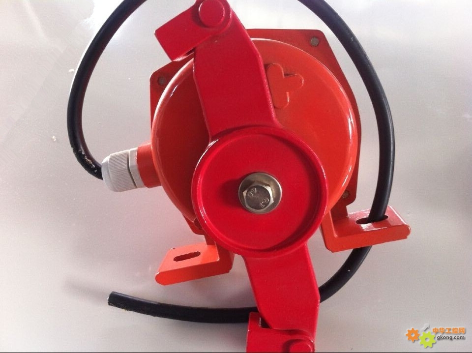

²úÆ·Ãû³Æ£º KLT2-IË«ÏòƽºâÀ­Éþ¿ª¹Ø-×Ô¶¯¸´Î»
ÐÍ ºÅ£º KLT2-I
À­Éþ¿ª¹ØKLT2-I¼¼ÊõÖ¸±ê£º
½ÓµãÈÝÁ¿£ºAC380V 3A 5A 10A
¾øÔµµçѹ£ºAC1000VÀúʱ1min
ʹÓÃÊÙÃü£º10Íò´Î
½ÓµãÐÎʽ£ºË«¶Ïµã£¨I³£¿ªI³£±Õ£©
»·¾³Î¶ȣº-20-+60¡æ
Ïà¶Ôζȣº²»´óÓÚ90%
º£°Î¸ß¶È£º£¼2000m
¶¯×÷½Ç¶È£º15°¼«Ï޽ǶÈ75°
À­Éþ¿ª¹ØKLT2-I½á¹¹Ìصã
1.±¾»ú²ÉÓÃÂÁºÏ½ð¾«ÃÜѹÖý¿ÇÌ塢ǿ¶È¸ß¡¢ÖØÁ¿Ç᣻
2.Íâ¿Ç·À»¤µÈ¼¶´ïIP67£¬¿ÉÔÚ¶ñÁÓ»·¾³Öй¤×÷£»
3.»úÄÚ²ÉÓýø¿ÚÐг̿ª¹Ø£¬´¥µãÈÝÁ¿´ó£¬¶¯×÷ÁéÃô¡¢¿É¿¿.
×Ô¶¯Ð͸´Î»»úÐÍÔÚËÉ¿ª¸ÖË¿Éþ×Ô¶¯¸´Î»£¬ÊÖ¶¯¸´Î»»úÐÍÐèÒªÒª²Ù×÷¸´Î»ÊÖ±úºó·½¿É¸´Î»£»Ê¹ÓÃÊÙÃü³¤£»ÃÜ·âÐԺ㬾ßÓзÀ³¾¡¢·ÀÕð¡¢·À¸¯µÈÓŵ㣻»ú¿Ç²ÉÓÃÖýÂÁÖýÔì£¬ÖØÁ¿Çá¡¢Ó²¶ÈÇ¿¡£
KLT2-I Ë«ÏòƽºâÀ­Éþ¿ª¹ØÐͺÅ
HFKLT2-1¡¢HFKLT2-I¡¢HFKLT2-II¡¢KLT2-II¡¢XLLS-I¡¢XLLS-II¡¢DLS-I¡¢DLS-II¡¢DPLS-I¡¢DPLS-II¡¢HFKLT2-2¡¢KLT2-1¡¢KLT2-2¡¢YHLS-L¡¢FKLT2-Z¡¢
À­Éþ¿ª¹ØKLT2-I¸ÅÊö
ÓÃÓÚ½º´øÔËÊä»úÏÖ³¡·¢Éú½ô¼±Ê¹Êʱ£¬Æô¶¯±¾»ú¿ª¹Ø£¬Á¢¼´Í£»ú£¬·ÀֹʹʵÄÀ©´ó¡£±¾»úÓÉÓÚ°²×°·½±ã£¬¿ª¹Ø×ª»»¿É¿¿£¬ÔÚ½º´øÔËÊä»ú³¡µÃµ½¹ã·ºµÄÓ¦Óá£
À­Éþ¿ª¹ØKLT2-I¹¤×÷Ô­Àí£º
Ë«ÏòÀ­Éþ¿ª¹Ø·Ö¢ñÐÍ¢òÐÍÁ½ÖÖÐͺţ¬¢ñÐͶ¯×÷ºó×Ô¶¯¸´Î»¡£¢òÐͶ¯×÷ºóÓÐ×ÔËø×°Öã¨Ëø¶¨Ïú£©£¬ÐèÒªÊÖ¶¯À­³ö¸´Î»ºó¿ª¹Ø²ÅÄÜÖØÐÂʹÓᣱ¾¼þΪ˫Ïò¶¯×÷£¬À­Éþ±ÛÁ½¶Ë¾ù¿É°²×°À­Éþ£¬µ±½º´ø»úÔËÐгöÏÖ¹ÊÕÏÐèҪͣ»úʱ£¬ÏÖ³¡¹¤×÷ÈËÔ±À­¶¯À­Éþ£¬Ê¹×ª±Ûת¹ýÒ»¶¨µÄ½Ç¶È£¬´¥¶¯¹¤×÷¿ª¹ØºóÄÜͬʱ·¢³ö±¨¾¯ºÍÍ£»úÁ½×éÐźţ¬´ïµ½Ô¤·ÀºÍ¿ØÖÆÉ豸¼°²Ù×÷Ô±°²È«µÄÄ¿µÄ¡£
°²×°µ÷Õû
1.À­Éþ¿ª¹ØÓ¦°²×°ÏÖ³¡ÈËÐйýµÀÒ»²à£¬Ã¿25-30m°²×°Ò»Ì¨£º
2.½«°²×°Ö§¼Üº¸ÔÚ½º´ø»ú¼ÜÉÏ£¬È»ºóÓÃM10×40ÂÝ˨À­Éþ×Ó¿ª¹Ø¹Ì¶¨ÔÚ°²×°Ö§¼ÜÉÏ£º
3.À­Éþ¿ª¹ØÖ®¼äÓøÖË¿ÉþÁ¬½Ó£¬Á½¶ËÓøÖË¿ÉþÔúÍ·¹Ì¶¨£»
4.Ϊ·ÀÖ¹¸ÖË¿ÉþÏ´¹¶øÎóÖ÷Æô¶¯¿ª¹Ø£¬Ã¿3m×óÓÒº¸Ò»Íл·£»
5.Ê×β¸÷¼ÓÒ»µ÷ÕûÂÝ˨£¬ÓÃÓڹ̶¨¸ÖË¿Éþ£»
6.¸ÖË¿ÉþËɽôÊÊÒË£¬Ó¦±£Ö¤À­Éþ¿ª¹ØË³ÀûÆô¶¯ºÍ¿É¿¿¸´Î»¡£
