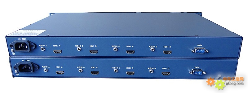

²úÆ·Ãû³Æ£º 4·HDMI¸ßÇåÊý×ÖÊÓÆµ¹â¶Ë»ú
ÐÍ ºÅ£º HY-HDMI-S4100
¡î4·HDMI¸ßÇåÊý×Ö¹â¶Ë»ú
²úÆ·¸ÅÊö
1¡¢Ö§³ÖµçÄÔ×î¸ß·Ö±æÂʸߴï1920×1080@60Hz¡£
2¡¢Ö§³ÖHDTV×î¸ß½âÎö¶È¸ß´ï1080P¡£
3¡¢Ö§³ÖHDMI1.3½Ó¿Ú£¬¼æÈÝHDMI1.2a±ê×¼¡£
4¡¢Ö§³Ö2-4·HDMIÐźÅÊäÈë¡£
5¡¢Ö§³Ö2-4·¶ÀÁ¢ÒôƵÊäÈë
6¡¢Ö§³ÖRS232/RS485/422/µÈ¿ØÖÆÊý¾Ý
7¡¢¹âÏ˽ӿÚFC¡£
8¡¢²ÉÓõ¥Ð¾µ¥Ä£¹âÏË´«Êä¡£
9¡¢HDMIÊäÈëÊä³öÓÐЧӦ´«ÊäµçÀ¾àÀë×î´ó¿É´ï15Ãס£
10¡¢Ö§³ÖÊäÈ룬Êä³öÐźÅָʾ
11¡¢Ö§³Ö¼´²å¼´Óá£
ÌØµã
µ¥ÏË´«Êä4·HDMIÐźÅÁíÍâ¿É´«Êä4·¶ÀÁ¢ÒôƵºÍÊý¾Ý£¬HDMIÒôÊÓÆµÐźÅ,ÔÚ²»¾­¹ý¶ÔÐźŽøÐÐÈκδ¦Àíºó£¬¸ß±£ÕæÊä³ö“Ô­×°”µÄÒôÊÓÆµÐźš£
ͨ¹ýһо¹âÏË¿ÉÒÔ´«Ê䣺£¨4·µ¥ÏòHDMIÒôÊÓÆµÐźÅ/2·˫ÏòÒôÊÓÆµÐźÅ/3·ÕýÏò1··´ÏòÒôÊÓÆµÐźţ©
1¡¢Ö§³ÖHDMI1.3½Ó¿Ú
2¡¢¸ß´ï720p/1080i/1080p/µÄHDTVÊÓÆµ·Ö±æÂÊ
3¡¢µ¥Ð¾µ¥Ä£¹âÏË
¡¾ ²úÆ·Ó¦ÓÃ ¡¿
1¡¢HDMI¹â¶Ë»úÊÇÒ»¸ö¸ßÐÔÄÜ£¬µÍ¹¦ºÄ£¬HDMI¹âÏË´«Êäϵͳ¡£
2¡¢Í¨¹ýÒ»Ìõµ¥ÏË¿ÉÒÔ´«Êäһ·µ¥ÏòHDMIÊÓÒôƵÐźš£
3¡¢ÕâÖÖ¶ÀÌØµÄ¹âÏË´«Êäϵͳ¿ÉÈÃÄúµÄÊý×ÖÆ½°åÏÔʾÆ÷ÔÚ1080p·Ö±æÂʵÄÇé¿öÏ´«ÊäÔ¶¾àÀë¡£
4¡¢Í¨¹ýÒ»¸öDVIµ½HDMIµÄÊÊÅäÆ÷µçÀ£¬¿ÉʵÏÖDVIÊÓÆµ¡£
5¡¢ÓÉÓÚ²ÉÓÃÁËÏȽøµÄÊý×Ö¹âÏË´«Êä¼¼Êõ£¬ÔÚϵͳÖÐÓû§¿É²»×÷Èκε÷Õû£¬Éè¼Æ¼òÒ×£¬¹¤×÷°²È«Îȶ¨¿É¿¿¡£
6¡¢Ö§³Ö¸ß´ïWUXGA(1920 x 1080 @ 60 Hz) »ò 720p/1080i/1080pµÄ¸ßÇåÊÓÆµ·Ö±æÂÊ¡£
7¡¢Óû§µÄÌØÊâÒªÇó¿ÉÓëÎÒ˾¹µÍ¨ºóÌṩ½â¾ö·½°¸¡£
¼¼Êõ²ÎÊý±í
  ÊÓ Æµ ²Î Êý
PCÊäÈë×î¸ß·Ö±æÂÊ 1920*1080@60Hz
HD-DVDÊäÈë×î¸ß½âÎö¶È 720p/1080i/1080p
ÊäÈëÊä³öTDMSÐźŴø¿í 4.65Gpbs
ÊäÈëÊä³öTDMSÐŽеçѹ 1.2volts p-p
ÊäÈëDDCÐźŵçѹ
5volts p-p (TTL)
¹âÏ˲ÎÊý
¹âÏËÑ¡Ôñ ·ûºÏIEEE802.3zÖÐ1000base_LX¹âÁ¬½Ó¹æ·¶
ÊäÈë¹âÖÐÐIJ¨³¤ 1310nm
·¢É书ÂÊ £­9.5¡«£­3dBmƽ¾ù¹â¹¦ÂÊ@850nm
¹â½ÓÊÕÁéÃô¶È £­23dBmƽ¾ù¹â¹¦ÂÊ@850nm
Êä³ö¹âµ÷ÖÆ·ù¶È 180μW
ÊäÈë¹âµ÷ÖÆ·ù¶È ≤15μW
Ïà¶ÔÀëѶǿ¶È -116 DB/Hz
»Ø²¨ËðºÄ ≤10 dB
´«ÊäÂëËÙÂÊ 240M Hz¡«4.65G Hz
´«Êä¾àÀë 1Ãס«500Ã×¶àÄ£¹âÏË£¬1Ãס«20¹«Àﵥģ¹âÏË
ÒôƵ²ÎÊý£º
ÒôƵÊäÈë/Êä³ö×迹------------------------------------------- 600 Ohm£¨·Çƽºâ£©
ÒôƵ×î´óÊäÈë/Êä³öµçѹ----------------------------------------- 4.0Vp-p
ƵÏì-------------------------------------------------------------10¡«20kHz
×Üг²¨Ê§Õæ---------------------------------------------------- <0.05%
ÐÅÔë±È-------------------------------------------------------- > 95dB£¨¼ÓȨ£©
ÐŵÀÎïÀí½Ó¿Ú-------------------------------------------------- ±ê×¼3.5ÉùµÀ²å¿×
Êý¾Ý²ÎÊý£º
Êý¾Ý¸ñʽ-------------------------------------------- RS232¡¢RS422¡¢RS485¡¢ÂüÂë,BIPHASEµÈ
Êý¾ÝËÙÂÊ--------------------------------------------------------0¡«300kbps
ÎóÂëÂÊ----------------------------------------------------------- 10-9
ÐŵÀÎïÀí½Ó¿Ú--------------------------------------------------- ±ê×¼·ï»Ë½ÓÏß¶Ë×Ó
µçÔ´Óë»·¾³Ö¸±ê
·¹¦ÂÊ 25W
·µçÔ´ÊÊÅäÆ÷ ·220VAC
·¹¤×÷ζȷ¶Î§ -40°C to +70°C
·Ïà¶Ôʪ¶È < 95% (ÎÞÀäÄý)
ÍâÐγߴç
1U»ú¼Üʽ…………………………………………485L×255W×46H£¨mm£©
