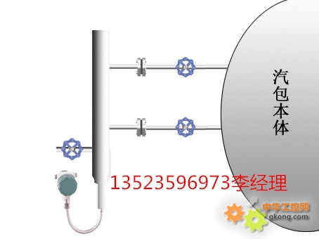

²úÆ·Ãû³Æ£º CAPÖÇÄܹøÂ¯Æû°üҺλ¼Æ³ýÑõÆ÷ˮλ¼Æ
ÐÍ ºÅ£º FRD-803
¼¼ÊõÌØµã
1¡¢Á½ÏßÖÆµçÁ÷»·£¬²âÁ¿ÏµÍ³ÓëµçÁ÷»·¸ôÀë;
2¡¢¾ßÓÐÈ«¹¤¿öÌõ¼þ(¹øÂ¯Æô¡¢Í£¡¢ÅÅÎÛ¡¢Ê¹ʹ¤¿öµÈ)ÏÂҺλ׼ȷÁ¬Ðø²â¿Ø¹¦ÄÜ;
3¡¢Äܹ»¶ÔÒºÏà½éÖʽéµç³£Êý±ä»¯¡¢ÆûÏà½éÖʽéµç³£Êý±ä»¯Í¬Ê±½øÐÐ×Ô¶¯²¹³¥£¬ÎÞÐèÏÖ³¡±ê¶¨;
4¡¢Äܹ»¶Ô²âÁ¿ÏµÍ³µÄÎÂ¶ÈÆ¯ÒƽøÐÐ×Ô¶¯²¹³¥£¬È«Î¶ȷ¶Î§²âÁ¿ÏµÍ³ÎÂÆ¯²»³¬¹ý0.1pF;
5¡¢¾­CEÈÏÖ¤µÄÁ¼ºÃµÄµç´Å¼æÈÝÌØÐÔ;
6¡¢Ä͸ßΡ¢¸ßѹ¡¢³¤ÊÙÃü;
7¡¢¸ß¿É¿¿¡¢¸ß¾«¶È¡¢¸ßÎȶ¨;
8¡¢²»´æÔÚ“¼Ùˮλ”²âÁ¿;
Èý¡¢¼¼Êõ²ÎÊý
¹¤×÷µçѹ£ºDC24V
Êä    ³ö£º4-20mA¶þÏßÖÆ+HartЭÒé
·À±¬±êÖ¾£ºExiaIICT6
¹¤×÷ѹÁ¦£º≤16MPamax
²âÁ¿·¶Î§£º≤4000mm
»·¾³Î¶ȣº-40¡æ¡«80¡æ
½éÖÊζȣº≤600¡æ  max.
µäÐÍÓ¦Ó㺸÷ÖÖ¹æ¸ñ¹¤ÒµÆû°ü¡¢¸ß¼Ó¡¢µÍ¼ÓµÈѹÁ¦ÈÝÆ÷£¬×ª»¯Â¯ÒºÎ»²â¿ØµÄҺλ²â¿Ø
