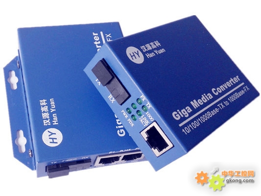

HY3212G-SC25A/B¹âÏËÊÕ·¢Æ÷£¬ÊÇÎÒ¹«Ë¾×¨ÃÅΪ¥Óî×Ô¶¯»¯¡¢Èõµç¹¤³Ì¡¢ÍøÂç¸ßÇå¼à¿ØÏµÍ³µÈÓ¦ÓÃÁìÓò¿ª·¢µÄÒ»¿î¸ßÐԼ۱ȹâÏËÊÕ·¢Æ÷²úÆ·£»
HY3212G-SC25A/BÌṩ1¸ö1000BaseFX¹âÏ˽ӿڣ¬SC½ÓÍ·£¬µ¥Ä£/¶àÄ£¡¢µ¥ÏË/Ë«ÏË¿ÉÑ¡£¬µ¥Ä£ÐͺűêÅä25KM¹âÏË´«Êä¾àÀ룬ҲÌṩ40KM/60KM/80KM¹âÏË´«Êä¾àÀë¿ÉÑ¡£»Í¬Ê±Ìṩ2¸ö10/100/1000M×ÔÊÊÓ¦RJ45µç¿Ú,Ö§³Ö10MbpsºÍ100Mbps,1000Mbps¡¢È«Ë«¹¤/°ëË«¹¤ºÍMDI/MDIX×ÔÊÊÓ¦£»¸Ã²úÆ·²ÉÓÃ×îнø¿Ú¸ßÐÔÄÜÍøÂç½»»»ICоƬ£¬ËùÓж˿ھùÖ§³ÖÎÞ×èÈû¡¢È«ÏßËÙÊý¾Ý°üת·¢£»
¸Ã²úÆ·²ÉÓüӺñÐÍÂÁºÏ½ðÍâ¿Ç£¬ ÃÀ¹ÛÇÒ½áʵÄÍÓ㬠¹¤×÷ζÈ-30°C-+75°C£» ²¢ÇÒ²úÆ·µÄƽ¾ùÎÞ¹ÊÕϹ¤×÷ʱ¼ä´ïµ½100 000СʱÒÔÉÏ£»
 ººÔ´¸ß¿Æ¹âÏËÒÔÌ«Íø²úÆ·¾ùÂú×ã½øÍø¼ì²â£¬CE/FCC£¬µÈ±ê×¼Öи÷ÏîÖ¸±ê£¬¸ßÎȶ¨ÐÔ¡¢¸ß¿É¿¿ÐԵıíÏÖÊÇÈõµç¹¤³ÌµÄÀíÏëÑ¡Ôñ¡£HY3212G-SC25A/B²ÉÓù¤Òµ¼¶Éè¼ÆºÍÆ÷¼þ£¬ÊÊÓÃÓÚ»·¾³¶ñÁÓ£¬´«Êä¿É¿¿ÐÔÒªÇ󳡺ϡ£
¹¦ÄÜÌØÐÔ
1.Ö§³Ö10Base-T¡¢100Base-TX¡¢100Base-FX1000Base-TXµÈЭÒé
2. 10/100/1000Mbps×ÔÊÊÓ¦£¬±ãÓÚÍøÂçµÄÉý¼¶
3.Ö§³ÖAC-220V/DC-12V/DC-5V¹©µç£¬Âú×ã¶àÖÖ³¡ºÏµÄÓ¦ÓÃÐèÇó
4. Ö§³ÖÖ±Á¬½»²æ×Ô¶¯Ê¶±ð(AUTO-MDIX)
5. Ö§³Ö×ÔЭÉÌ»òÇ¿ÖÆÄ£Ê½£¬Ö§³Öȫ˫¹¤ºÍ°ëË«¹¤ÍøÂçͨÐÅ
6. Ö§³ÖVLAN¸ôÀ룬ÀûÓÚ¶à·½Ê½ÍøÂçÖÇÄܹÜÀí
7. ´øÓзÀ¾²µç¡¢·ÀÀËÓ¿±£»¤¹¦ÄÜ£¬È·±£¶ñÁÓ»·¾³ÏµÄÎȶ¨¹¤×÷
8.ÏȽøµÄ¼¼Êõ·½°¸ÓëÐÔÄÜÓÅÒìµÄ¼¯³ÉоƬ½áºÏ£¬¿¹µç´Å¸ÉÈÅÄÜÁ¦Ç¿
9.µÍ¹¦ºÄÎÞ·çÉÈÉè¼Æ£¬Á¼ºÃµÄÉ¢ÈÈÐÔ,±£Ö¤³¤Ê±¼äµÄÎȶ¨¹¤×÷
10. Æ½¾ùÎÞ¹ÊÕϹ¤×÷ʱ¼ä³¬¹ý10ÍòСʱ£¬Âú×ãµçÐż¶ÔËÓª±ê×¼
