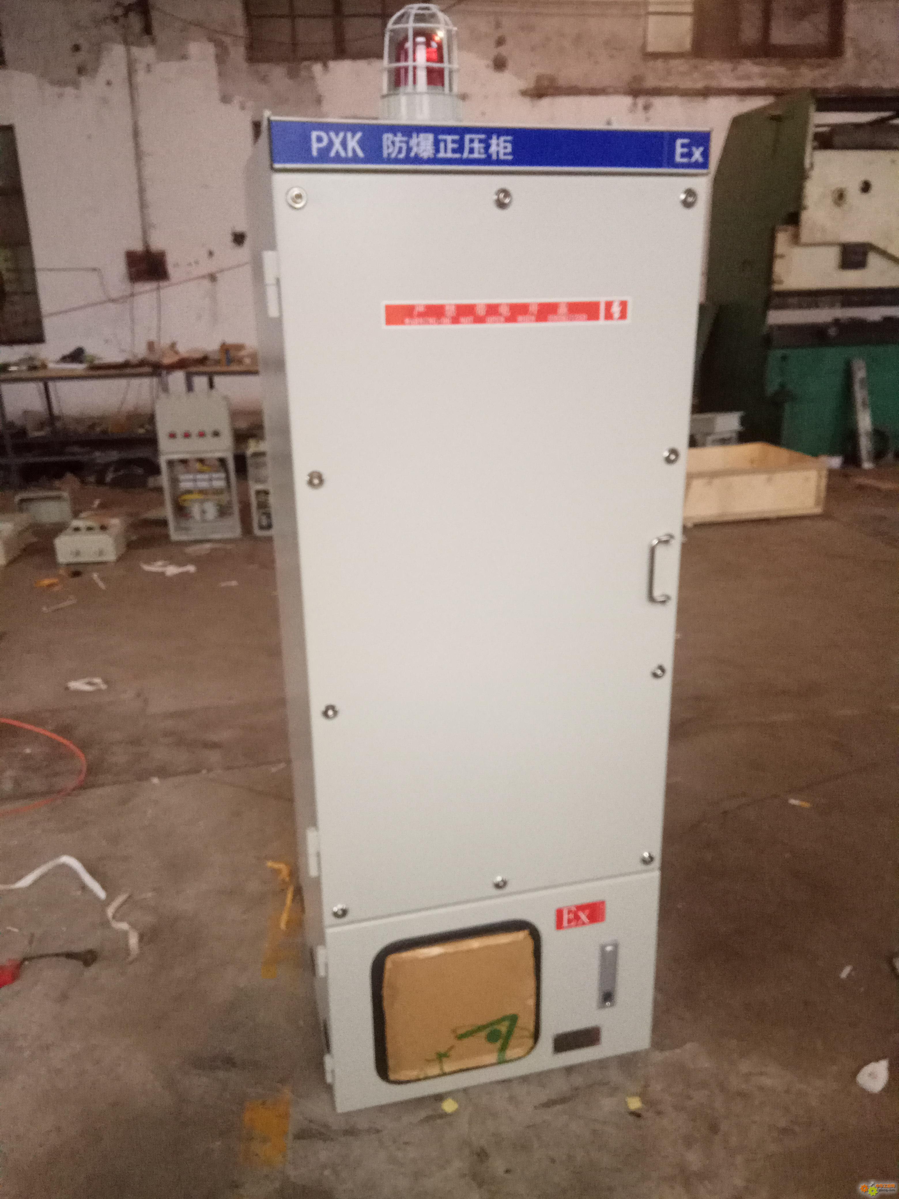

ËÄ ²úÆ·µÄ°²×°
Ò»¡¢ ¹ñÌå°²×°
1¡¢ ¹ñÌåµÄ°²×°Î»Ö㺻§ÄÚ»ò»§ÍâÓÐÅï¶¥£¬ÎÞÃ÷ÏÔÕð¶¯Æ½Ì¹µÄµØ·½¡£
2¡¢ ±¾²úÆ·°²×°·½Ê½ÎªÂäµØÊ½ºÍ±Ú¹Òʽ£¬±¾¹ñÉèÖÃÁËרÓÃÓڹ̶¨µÄ°²×°¿×£¬¾ßÌå²ÎÊýÏê¼û¼¼Êõ¸½¼þ»ò²úƷʵÎï¡£
3¡¢ ²¼Ïß·½Ê½ÎªµçÀ²¼Ïߣ¬Óû§µçÀ½ṹ¿É²Î¿¼Ïà¹Ø¹ú¼Ò±ê×¼ºÍÐÐÒµ±ê×¼£¬²¢½áºÏ±¾¹ñµÄ½á¹¹ÒªÇó½øÐÐÉè¼Æ¡¢Ê©¹¤¡£
4¡¢ °áÔËʱעÒ⣬±¾²úÆ·ÑϽû´ó·ù¶ÈÇãб£¬Çãб¶È²»´óÓÚ100¡£
5¡¢ ±¾²úÆ·ÔÚÔËÊä¡¢°²×°¶¨Î»Ê±£¬ÑϽû²ÉÓÃÇË¡¢´¸µÈ·½Ê½½øÐаᶯ¡£·ñÔò£¬¿ÉÄÜÓ°Ïì²úÆ·µÄÃÜ·âÐÔÄÜ£¬µ¼Ö±¾²úÆ·ÎÞ·¨Õý³£ÔËÐС£
6¡¢ ±¾²úÆ·ÉèÖÃÁ˽øÆø¿ÚºÍÅÅÆø¿Ú£¬¹©Óû§½Ó¹Ü¡£Óû§Ðë°´“ÆøÂ·¹ÜµÀ²¼ÖÃͼ”²¼ÖýøÆø¹ÜµÀ£¬ÅÅÆø¿Ú¾­¹ý·À»ð·§ºóÔÚÏÖ³¡ÅÅ·Å»òÒýÖÁ°²È«ÇøÓòÅÅ·Å£¬Óû§ÏÖ³¡ÐëÌṩ½øÆøÆøÔ´£¨±£»¤ÆøÌ壩£¬ÆøÔ´Ñ¹Á¦Ò»°ã¿ØÖÆÔÚ0.2-0.6MPa£¬½øÆøÆøÔ´Îª¾»»¯¿ÕÆø£¨È磺ÒDZí·ç£©»òµªÆø£¬£¨×¢Ò⣺ÔÚÃܱյIJÙ×÷ÊÒÀҪ½÷É÷ʹÓõªÆø×÷Ϊ±£»¤ÆøÌ壬Èô±ØÐëʹÓõªÆø×÷±£»¤ÆøÌ壬Çë×¢ÒâÏÖ³¡Í¨·ç£¬ÒÔÈ·±£ÈËÉí°²È«£©¡£
7¡¢ ÓÉÓÚÄÚ×°¹¤¿ØµçÆ÷¡¢´¥ÃþÆÁµÈ¾«ÃܵçÆ÷£¬ÆøÔ´½ø¿Ú´¦Ðè¼Ó×°¸ÉÔï¹ýÂËÆ÷£¬ÒÔÈ·±£ÆøÔ´Îª¸ÉÔïÇå½àµÄ¿ÕÆø£¬·ñÔò»áÓ°ÏìµçÆ÷µÄʹÓÃÊÙÃü¡£
8¡¢ ÑϽû½øÆøÆøÔ´Îª±¬Õ¨ÐÔ»ìºÏÆøÌ壡£¡
²»Ðâ¸Ö·À±¬Õýѹ¹ñ¼Û¸ñ
¶þ¡¢ Óû§Ôª¼þµÄ°²×°
1¡¢ ÓÉÓÚÄÚ×°ÅäµçϵͳԪ¼þÓÉÓû§×ÔÐе÷Õû£¬Òò´Ë£¬Óû§±ØÐëÔÚ°²È«ÇøÄÚ½øÐÐÉ趨¡¢µ÷ÊÔ¡£
2¡¢ ²»µÃ³·²ðÃæ°åÉϵĵçÆ÷Ôª¼þ£¬ÒÔÃâÓ°Ïì¹ñÌåµÄÆøÃÜÐÔÄÜ¡£
Èý¡¢ µçÆø°²×°
1¡¢ ±¾²úÆ·±ØÐëÓÉרҵµç¹¤£¬½øÐвÙ×÷¡£
2¡¢ Óû§°´ÎÒ¹«Ë¾ÌṩµÄµçÆ÷ϵͳͼ¡¢½ÓÏßͼ¡¢¶Ë×ÓͼµÈ¼¼ÊõÎļþ£¬½áºÏ²úƷʵ¼ÊÇé¿öÖðÒ»¶ÔÓ¦½øÐнÓÏß¡£
3¡¢ ½ÓÏßʱ£¬Çë×¢Òâ¸÷½ø³öµçÀµÄÃÜ·âÐÔ£¨ÑϽû½«Í¨Í·ÖеÄÃÜ·âȦÆúÖ®²»Óã©£¬²¢ÊÓ¸÷µçÀµÄËɽô³Ì¶È£¬Ó÷À±¬½ºÄà×÷Êʵ±µÄÃÜ·â´¦Àí¡£
4¡¢ Óû§µÄ½ÓÏß¡¢µ÷ÊÔÍêºó£¬½«¸÷ÃŹرÕʱ£¬Ò»¶¨Òª±£Ö¤ÆäÃÜ·âÐÔÄÜ¡£
5¡¢ ±¾¹ñÌ屨Ðë°´ÒªÇ󽫽ӵØÏß½Óµ½×¨ÓýӵØÂÝË¿ÉÏ¡£
