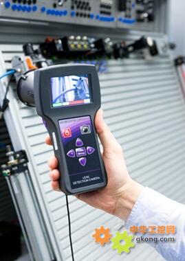

1.À¥É½ºº¼ªÁú¹«Ë¾Ìṩԭװ·¨¹ú½ø¿Ú¿ÉÊÓ»¯³¬Éù²¨¼ì©ÒÇÊÇÓɺº¼ªÁú´úÀíµÄ¸ßÆ·ÖÊй©¼ì²âÒÇÆ÷£¬Êǵ±Ç°¼¼ÊõÏȽø£¬¸ßЧ¿É¿¿µÄй©²âÊÔ½â¾ö·½°¸¡£
2.¸Ã²úÆ·ÒÔ³¬Éù²¨´«µ¼ÎªÔ­Àí£¬ÄÚÖøßÇåÏÔʾÆÁºÍ³¬Éù²¨¸ÐÓ¦Æ÷£¬¿ÉÓÃÓÚ¼ì²âÆøÌåй©£¬Õæ¿Õй©£¬ÒÔ¼°±»²â²úÆ·ÆøÃÜÐÔ»òÕß»úе²¿¼þÒìÏìµÈȱÏÝ¡£Ê¹ÓÃÕß¿Éͨ¹ý¸ÃÒÇÆ÷¿ìËÙÖ±¹ÛµØ¶¨Î»Ð¹Â©Î»Ö㬲¢¿ÉÅÄÕռǼ¡£Í¨¹ýÊý¾Ý´«Ê䣬»¹¿ÉÉÏ´«ÕâЩÕÕÆ¬ÖÁPC¶Ë£¬ÓÃÓÚºóÐøÅŹʻòÕß¹¤ÒոĽø¡£
¶þ.ʹÓ÷½Ê½
ÊÖ³Ö¿ÉÊÓ»¯³¬Éù²¨¼ì©ÒÇÑØÇ±ÔÚÐ¹Â©ÇøÓòɨÃ裬ÒÇÆ÷¼ì²âµ½Ð¹Â©Ðźźó»áÔÚ²ÊɫҺ¾§ÆÁÄ»ÉÏÏÔʾ²¢¿òÑ¡³öй©µã¡£ÔÚÒº¾§ÆÁÄ»ÉÏʵʱÏÔʾµÄй©ԴÊÇ»ÆÉ«¿ò£¨ËµÃ÷й©½ÏС£¬ÐźŽÏÈõ£©»òÕߺìÉ«¿ò£¨ËµÃ÷й©½Ï´ó£¬ÐźÅÇ¿£©»òÕßÎÞ¿ò£¨ËµÃ÷ÎÞй©£¬ÎÞÐźţ©£¬Í¬Ê±ÔÚÒº¾§ÆÁÄ»µ×²¿µÄºáÌõ¹âÖùÒÔ²»Í¬ÑÕÉ«ºÍÊýÖµÏÔʾ³öÀ´¡£
