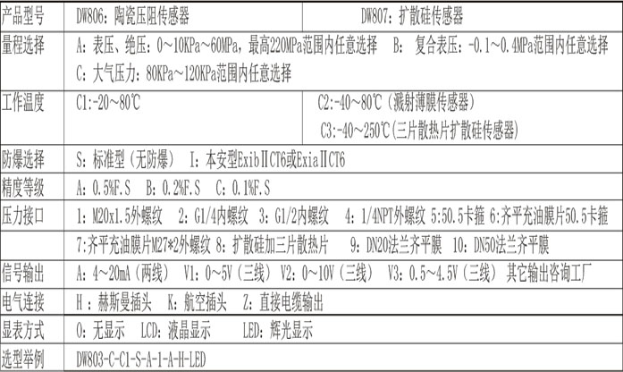

²úÆ·Ãû³Æ£º DW806/7
ÐÍ ºÅ£º DW806/7
Ò»¡¢¼¼ÊõÖ¸±ê
Á¿    ³Ì£º0~60MPa(¾ßÌå²úÆ·µÄÁ¿³ÌÏê¼û²úÆ·ÃúÅÆ)
²âѹÐÎʽ£º±íѹ¡¢¾øÑ¹
²¹³¥Î¶ȣº-10~70¡æ
¹¤×÷ζȣº- 20~75¡æ(ÌØÊâ¸ßÎÂÐͿɴï300¡æ)
×ۺϾ«¶È£º0.25£¬0.5
Êä³öÑ¡Ôñ£º4~20mA  (¾ßÌå²úÆ·µÄÊä³öÏê¼ûÃúÅÆ)
µçÔ´µçѹ£º24VDC
±¸×¢£ºµ±Á¿³ÌСÓÚ10KPaʱ£¬²âÁ¿½éÖʱØÐëÊÇÎÞ¸¯Ê´µÄÆøÌå
¶þ¡¢²úÆ·Ñ¡ÐÍ
Èý¡¢½Ó¿ÚÀàÐÍ
    Ñ¹Á¦½Ó¿ÚΪ±ê×¼µÄM20×1.5ÍâÂÝÎÆ£¬ÄÚ¿×Ϊ§¶3mm£¨ÈçÓÐÌØÊâÒªÇó¿É°´Óû§ÒªÇó¼Ó¹¤£©¡£
