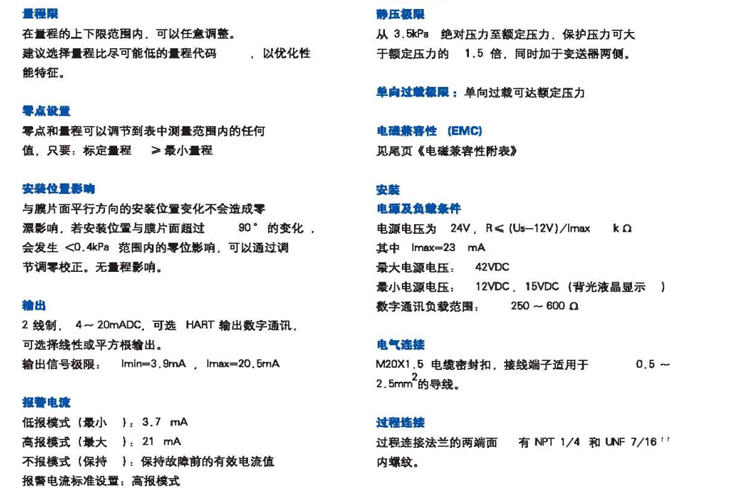

Ò»¡¢²úÆ·ÌØµã
  1¡¢²ÉÓÃÏȽøµÄµ¥¾§¹è¼¼Êõ£¬Í¨¹ýÖÇÄÜ´¦ÀíÆ÷ËæÊ±ÐÞÕý¾²Ñ¹Îó²î£¬Ìá¸ß²úÆ·¾«¶ÈºÍÎȶ¨ÐÔ,Ïû³ýÄ£ÄâÐźŴ«ÊäÎó²î¡£
  2¡¢¶àÖØµ÷ÊÔ·½Ê½£»¾ÍµØ°´¼ü,ÊÖ²ÙÆ÷£¬Í¨ÐÅÈí¼þ
  3¡¢Êä³öͨÐÅЭÒ飺HART
  4¡¢·À»¤µÈ¼¶£»IP67
  5¡¢¾ßÓи÷ÖÖ·À¸¯²ÄÁϱ¸Ñ¡£¬¿ÉÂú×ã¸÷ÖÖ¹¤¿öÌõ¼þÏÂʹÓá£

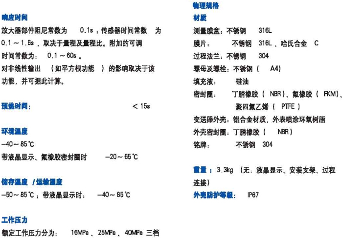

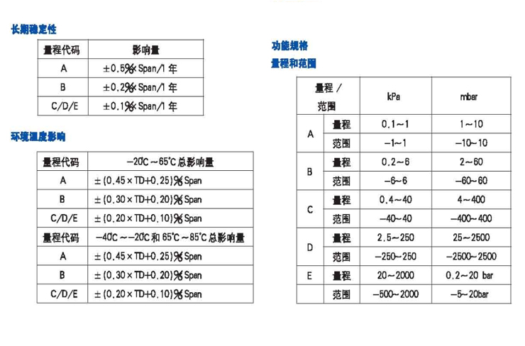

¶þ¡¢ ¼¼Êõ²ÎÊý
  »·¾³Î¶ȣº-40¡æ~+85¡æ
  (´øLCD±íÍ·¡¢³å·úÓÍ£º-20¡æ~+60¡æ)
  ´¢´æÎ¶È/ÔËÊäζȣº-50¡«85¡æ
  ´øÒº¾§ÏÔʾʱ£º-40¡«85¡æ
  ³¤ÆÚÆ¯ÒÆ£º±0.1%URL/Äê
  Êä³öͨѶЭÒ飺HART
  Êä³ö¹¦ÄÜ£ºÏßÐÔ
  ·À»¤µÈ¼¶£ºIP67
  ¹à³äÒº£º¹èÓÍ¡¢·úÓ͵È
