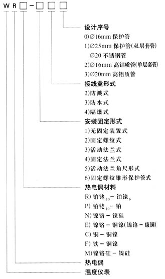

¹¤ÒµÓÃ×°ÅäʽÈȵçż×÷ΪһÖÖζȴ«¸ÐÆ÷£¬Í¨³£ºÍÏÔʾÒÇ±í£¬¼Ç¼ÒDZíºÍµç×Óµ÷½ÚÆ÷ÅäÌ×ʹÓá£×°ÅäʽÈȵçż¿ÉÒÔÖ±½Ó²âÁ¿¸÷ÖÖÉú²úÖдÓ0¡æµ½1800¡æ·¶Î§µÄÒºÌåÕôÆûºÍÆøÌå½éÖÊÒÔ¼°¹ÌÌåµÄ±íÃæÎ¶ȡ£
¸ù¾Ý¹ú¼Ò¹æ¶¨£¬ÎÒ¹«Ë¾Éú²ú·ûºÏIEC¹ú¼Ê±ê×¼·Ö¶ÈºÅµÄ²¬îî 30£­²¬îî6¡¢²¬îî10£­²¬¡¢Äø¸õ£­Äø¹è¡¢Äø¸õ£­¿µÍ­µÈµÈµÄ×°ÅäʽÈȵçż¡£
×°ÅäÈȵçżͨ³£ÓɸÐÎÂÔª¼þ¡¢°²×°¹Ì¶¨×°ÖúͽÓÏߺеÈÖ÷Òª²¿¼þ×é³É¡£
