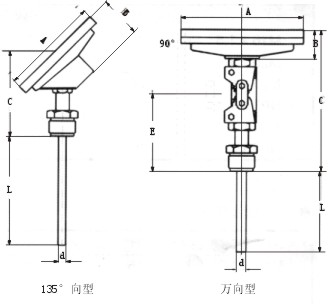

ÍâÐμ°³ß´ç
ÐÎʽ
A
B
C
E
L
d
ÖáÏòÐÍ
65
23
73
75
100
150
200
300
400
500
750
1000
¦µ6
¦µ8
¦µ10
105
23
73
155
23
73
¾¶ÏòÐÍ
65
110
34
105
110
34
105
110
34
135¡ãÏòÐÍ
105
23
85
155
23
85
ÍòÏòÐÍ
105
23
178
120
155
23
178
120
µã»÷¿´´óͼµã»÷¿´´óͼ

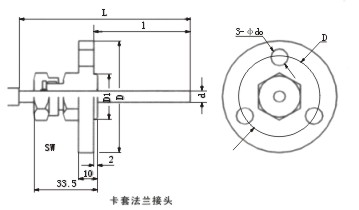

¿¨Ì×·¨À¼½ÓÍ·
D
D0
D1
SW
d0
d
¦µ60
¦µ42
¦µ24
¦µ22
¦µ9
¦µ8 ¦µ10
µã»÷¿´´óͼ

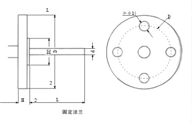

¹Ì¶¨·¨À¼
D
D1
D2
H
d0
d
¦µ105
¦µ75
¦µ55
¦µ16
¦µ14
¦µ8
¦µ10
