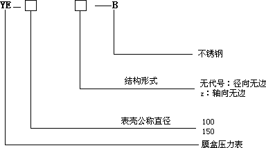

²úÆ·Ãû³Æ£º YE-100B¡¢150BϵÁв»Ðâ¸ÖĤºÐѹÁ¦±í
ÐÍ ºÅ£º YE-100B¡¢150B

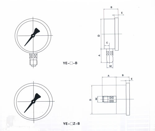

ÐÍ ºÅ ÍâÐͳߴç mm
A B C D E M
YE-100-B 43 45 16.5 98 10 20¡Á1.5
YE-100Z-B 41.5 45 / 98 10 20¡Á1.5
