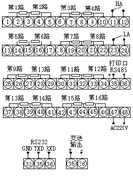

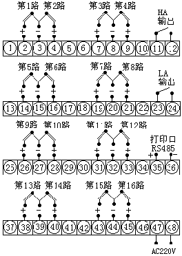

8·ÖÇÄÜѲ¼ìÒǶË×Ó½ÓÏß·½·¨
ÊäÈëÐźÅΪÈȵçż¡¢µçѹ¡¢µçÁ÷
ÊäÈëÐźÅΪÈȵç×è¡¢Ô¶´«µç×è
16·ÖÇÄÜѲ¼ìÒǶË×Ó½ÓÏß·½·¨
32·ÖÇÄÜѲ¼ìÒǶË×Ó½ÓÏß·½·¨
ÊäÈëÐźÅΪÈȵçżµçѹµçÁ÷
