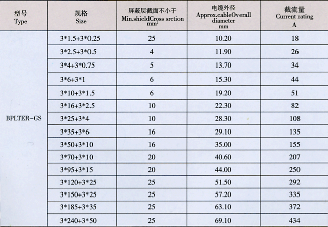

Ëæ×ÅÆµÂÊ¿ØÖÆ´«¶¯¼¼ÊõµÄ·¢Õ¹,¶ÔƵÂʱäËÙ´«¶¯ÏµÍ³µÄÒªÇóÔ½À´Ô½¸ß,ÓÈÆäÊǶԲÉÓÿìËÙÇл»µÄIG BT°ëµ¼ÌåÏÖ´ú±äƵ¼¼Êõ,¾¡¹ÜÂö³åƵÂʸ߻ò¸ü¶Ïʱ¼ä½öºÁÃëÖ®ÄÚ,µ«ËüÃÇ»á¶ÔÖÜΧ»·¾³²úÉúÑôÐԴų¡¡£Îª±£³Ö±äƵÆ÷Õý³£¹¤×÷,²»Êܵç´Å³¡¸ÉÈÅ,Òò´ËÁ¬½Ó±äƵÆ÷ÓëÈýÏཻÁ÷µç»úÖ®¼äµÄµçÀ¾ÍÒªÇó¾ßÓп¹¸ÉÈÅÐÔÄÜ¡¢½ÏµÍµÄÓÐЧµçÈݼ°½ÏµÍµÄ´«Êä×迹¡£
¼¼ÊõÊý¾Ý
1¡¢°´DIN VDEµÚÎåÀàµÄÈí½ÊºÏÍ­µ¼Ìå¡£
2¡¢ÄͺòÄÍÎÂÊ÷Ö¬¾øÔµ¡£
3¡¢Èí³¬ÆÁ±Î²ã¡£
ÐͺŹæ¸ñ¼°±íʾ·½·¨£º
ÔÊÐíζȼ°¹¤×÷µçѹ£º
1¡¢ÔÊÐíµ¼ÌåÁ¬Ðø¹¤×÷×î¸ßζÈ180ÉãÊ϶ȡ£¶Ì·ʱ×î¸ßζÈ250ÉãÊ϶ȡ£
2¡¢ÔÚÔËÊä¡¢´¢´æ¡¢·øÉä¡¢°áÔ˺Í×÷ҵʱ×ÔÓÉÍäÇú¡Ý+5¡æ£¬¹Ì¶¨·óÉè¡Ý-10¡æ¡£
3¡¢¶î¶¨µçѹ£º600/1000V£¬½»Á÷ÊÔÑéµçѹ3500V¡£
²úÆ·ÌØµã£º
1¡¢½ÏµÍµÄÓÐЧµçÈÝ¡£
2¡¢¾ßÓÐÆÁ±ÎÐÔÄÜ¡£
3¡¢Á¼ºÃµÄÄÍ»ðȼÉÕÐÔÄÜ£¬¿ÉÓÃÓÚΣÏÕÇøÓò¡£
4¡¢µÍ´«Êä×迹£¬¸ÃµçÀº¬ÓÐÆÁ±Î²ã£¬ÒÔ·ÀÖ¹µç´Å¸ÉÈÅ£¬´«Êä×迹RXÊÇ¶ÔÆÁ±Î¿¹¸ÐÓ¦ºÍµçÈÝÀ´ºÏµÄÓÐЧÐԵĶÈÁ¿£¬µÍ´«Êä×迹¿ÉÌṩÁ¼ºÃµÄµç´ÅÏàÈÝÐÔ¡£
5¡¢¶Ô³ÆµÄÈýоÉè¼Æ£¬¸üºÃµÄµç´ÅÏàÈÝÐÔ£¬±ÈËÄоµçÀ¸üºÃµÄÐÔÄÜ¡£Èý¸ùÄͺòÄÍÎÂÊ÷Ö¬¾øÔµÏßоÔÚ·ì϶´¦¾ùÔȵȾà½ÊºÏ£¬ÐγÉÒ»ÖÖÕæÕýµÄͬÐĽṹ
