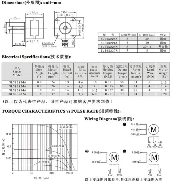

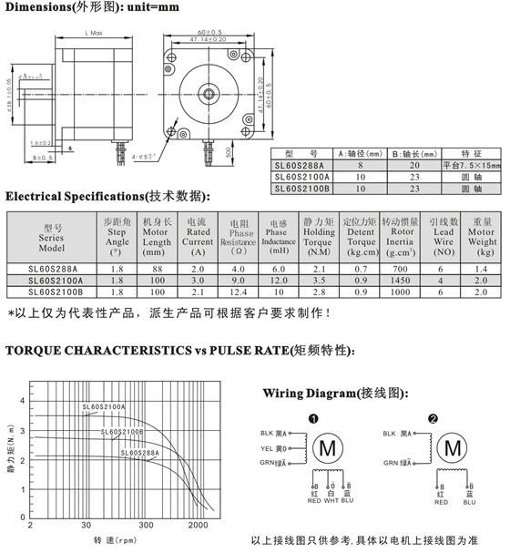

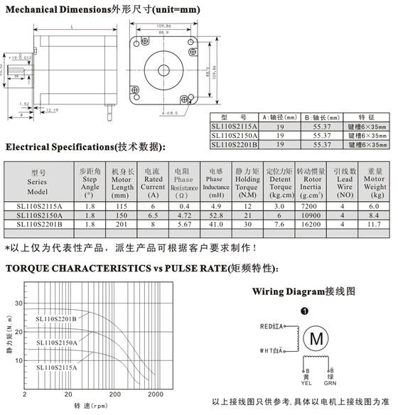

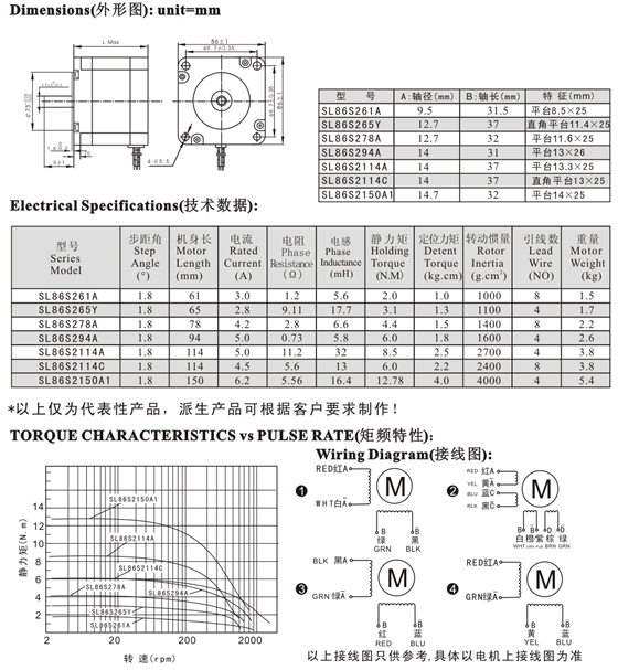

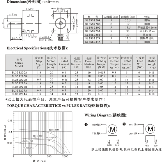

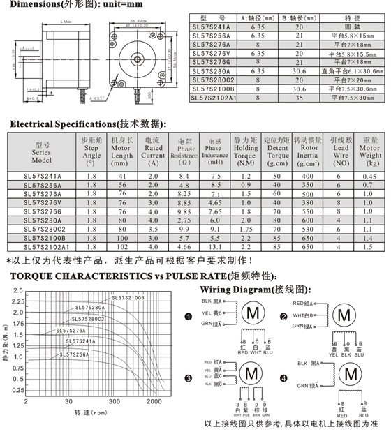

²úÆ·Ãû³Æ£º Á½Ïà110·½ÐÍϵÁв½½øµç»ú
ÐÍ ºÅ£º Á½Ïà110·½ÐÍϵÁÐ
Æ· ÅÆ£º ÉêÁ¦
²úÆ·±àºÅ£º62614351116
²úÆ·Ãû³Æ£ºÁ½Ïà110·½ÐÍϵÁв½½øµç»ú
¹æ¡¡¡¡¸ñ£º2Ïà110·½ÐÍ
²úÆ·±¸×¢£ºÏêϸ˵Ã÷Çëä¯ÀÀ¡°ÏÂÔØÖÐÐÄ¡±ÀïµÄ²úÆ·×ÊÁÏ»òÁªÏµÎÒÃÇ¡£
²úÆ·Àà±ð£ºÉêÁ¦²½½øµç»ú
