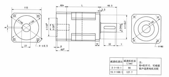

PG 115ÍâÐγߴç

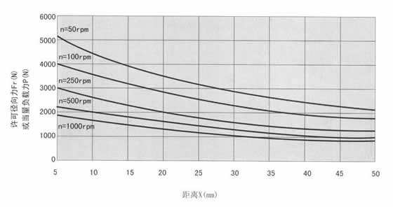

PG 115¾¶Ïò¸ºÔØ±í£¨±í2£©
ÖáÏò¸ºÔØ±í£¨±í3£©
n(rpm)
Fa(N)
8721
100
6452
250
4404
500
3689
1000
2480
×¢£º
£¨1£©ÉÏÊö£¨±í2£©±íʾÖáÏòÁ¦Fa=0ʱµÄÐí¿É¾¶ÏòÁ¦£¬£¨±í3£©±íʾ¾¶ÏòÁ¦Fr=0ʱµÄÐí¿ÉÖáÓÉÁ¦£¬µ±¼´Óо¶ÏòÁ¦ÓÖÓÐÖáÏòÁ¦Ê±£¬£¨±í2£©±íʾµ±Á¿Ðí¿É¸ºÔØÁ¦P£¬Õâʱ¿ÉÓù«Ê½P=0.56Fr+2Fa¶Ôʵ¼Ê¾¶ÏòÁ¦ºÍʵ¼ÊÖáÏòÁ¦½øÐÐÑéËã¡£
£¨2£©ÉÏÊöÈý±íÄÚµÄÊý¾ÝµÄ½âÊÍȨ£¬ÊôÓÚ±¾¹«Ë¾£¬²¢±£Áô²úÆ·¸üÐÂʱµÄÊý¾Ý±ä¸üȨÀû£¬Êý¾Ý±ä¸üʱˡ²»ÁíÐÐ֪ͨ¡£
