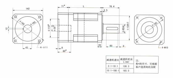

PG 142ÍâÐγߴç

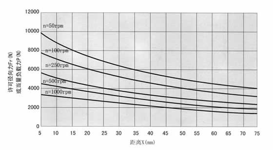

PG142¾¶Ïò¸ºÔرí
ÖáÏò¸ºÔØ±í£¨±í3£©
n(rpm)
Fa(N)
17057
100
13422
250
9232
500
6157
1000
5201
×¢£º
£¨1£©ÉÏÊö£¨±í2£©±íʾÖáÏòÁ¦Fa=0ʱµÄÐí¿É¾¶ÏòÁ¦£¬£¨±í3£©±íʾ¾¶ÏòÁ¦Fr=0ʱµÄÐí¿ÉÖáÓÉÁ¦£¬µ±¼´Óо¶ÏòÁ¦ÓÖÓÐÖáÏòÁ¦Ê±£¬£¨±í2£©±íʾµ±Á¿Ðí¿É¸ºÔØÁ¦P£¬Õâʱ¿ÉÓù«Ê½P=0.56Fr+2Fa¶Ôʵ¼Ê¾¶ÏòÁ¦ºÍʵ¼ÊÖáÏòÁ¦½øÐÐÑéËã¡£
