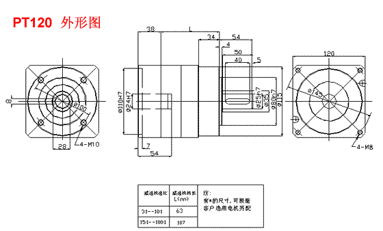

²úÆ·Ãû³Æ£º Golden SkyÐÐÐǼõËÙ»úPTϵÁÐ PT120
ÐÍ ºÅ£º PT120
Æ· ÅÆ£º Golden Sky
²úÆ·±àºÅ£º 6138514116
²úÆ·Ãû³Æ£º PT120
¹æ¡¡¡¡¸ñ£º ±³Ï¶¶È£º5¡«10
²úÆ·±¸×¢£º Ïêϸ˵Ã÷Çëä¯ÀÀ¡°ÏÂÔØÖÐÐÄ¡±ÀïµÄ²úƷ˵Ã÷Êé»òÁªÏµÎÒÃÇ¡£
²úÆ·Àà±ð£º Golden SkyÐÐÐǼõËÙ»ú
PT120ϵÁÐÐÔÄÜ±í£¨±í1£©
ÐͺÅ
¼õËÙ±È
¹¤×÷ÊÙÃü5000Сʱ
¹¤×÷ÊÙÃü10000Сʱ
×î´óŤ¾ØNm
Tpeak
ת¶¯¹ßÁ¿
kg-cm2
J
¿¹Å¤¸Õ¶ÈNm/arc-min
ÖØÁ¿
Kg
±³Ï¶
arc-min
(Max)
µ¥Î»£ºNm  ·ûºÅ£ºTr
µ¥Î»£ºNm ·ûºÅ£ºTr
1000
rpm
2000
rpm
3000
rpm
1000
rpm
2000
rpm
3000
rpm
PT120-003
3:1
110
90
78
95
80
68
290
7.03
11
5
5
PT120-004
4:1
153
112
90
140
100
80
290
5.57
11
5
5
PT120-005
5:1
180
145
120
160
100
90
290
4.83
11
5
5
PT120-010
10:1
110
90
78
95
80
70
290
3.45
11
5
5
PT120-015
15:1
175
130
100
140
100
85
290
5.73
11
10
10
PT120-020
20:1
200
175
155
190
160
140
290
5.41
11
10
10
PT120-025
25:1
230
200
185
210
185
170
290
5.26
11
10
10
PT120-030
30:1
175
160
130
160
130
100
290
4.15
11
10
10
PT120-040
40:1
200
175
155
190
160
140
290
4.00
11
10
10
PT120-050
50:1
190
170
140
170
140
110
290
3.66
11
10
10
PT120-100
100:1
115
95
80
95
80
70
290
3.53
11
10
10
×¢£º£¨1£©¼õËÙ±ÈÊǾ«È·µÄ¡£
    £¨2£©Tr±íʾÔÚÖ¸¶¨µÄÊÙÃüÆÚÏÞÄÚÔÚÖ¸¶¨µÄתËÙʱµÄ¶î¶¨Å¤¾Ø¡£
    £¨3£©J±íʾ¼õËÙ»úµÄת¶¯¹ßÁ¿£¬´ÓÊäÈëÖá´¦²â¶¨£¨°üÀ¨³ÝÂÖ¡¢Êä³öÖáµÈ£©¡£
    £¨4£©3:1ÖÁ10:1¼õËÙ»ú´«ËÍЧÂÊΪ90%;15:1ÖÁ100:1¼õËÙ»ú´«ËÍЧÂÊΪ85%¡£
    £¨5£©³£±¸Ëٱȣº3:1¡¢4:1¡¢5:1¡¢8:1¡¢10:1¡¢15:1¡¢20:1¡¢25;1¡¢30:1¡¢40:1¡¢50:1¡¢100:1¡£
PT120¾¶Ïò¸ºÔØ±í£¨±í2£©        µ¥Î»£ºX(mm)¡¢n(rpm)¡¢Fr(N)
x
5
10
15
20
25
30
35
40
45
n
Fr
3051
2574
2226
1961
1752
1584
1445
1328
1230
100
2421
2043
1767
1556
1391
1257
1147
1054
976
250
1784
1505
1302
1147
1025
926
845
777
719
500
1416
1195
1033
910
813
735
670
616
570
1000
1124
948
820
722
645
583
532
489
453
x
55
60
65
70
75
80
85
90
n
Fr
1144
1070
1004
946
895
849
807
769
735
100
908
849
797
751
710
674
641
611
583
250
669
625
587
553
523
496
472
450
430
500
531
496
466
439
415
394
374
357
341
1000
421
394
370
348
329
312
297
283
271
ÖáÏò¸ºÔرí(±í3)
N(rpm)
Fa(N)
5149
100
4021
250
2747
500
1827
1000
1547
×¢£º
£¨1£©ÉÏÊö(±í2)±íʾÖáÏòÁ¦Fa=0ʱµÄÐí¿É¾¶ÏòÁ¦£¬(±í3)±íʾ¾¶ÏòÁ¦Fr=0ʱµÄÐí¿ÉÖáÏòÁ¦£¬µ±¼´Óо¶ÏòÁ¦ÓÖÓÐÖáÏòÁ¦Ê±£¬(±í2)±íʾµ±Á¿Ðí¿É ¸ºÔØÁ¦P£¬Õâʱ¿ÉÓù«Ê½P=0.56Fr+2Fa¶Ôʵ¼Ê¾¶ÏòÁ¦ºÍʵ¼ÊÖáÏòÁ¦½øÐÐÑéËã¡£
£¨2£©ÉÏÊöÈý±íÄÚµÄÊý¾ÝµÄ½âÊÍȨ£¬ÊôÓÚ±¾¹«Ë¾£¬²¢±£Áô²úÆ·¸üÐÂʱµÄÊý¾Ý±ä¸üȨÀû£¬Êý¾Ý±ä¸üʱˡ²»ÁíÐÐ֪ͨ¡£
