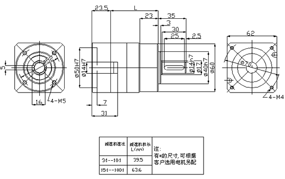

PT60ÍâÐÎͼ

×¢£º£¨1£©¼õËÙ±ÈÊǾ«È·µÄ¡£
    £¨2£©Tr±íʾÔÚÖ¸¶¨µÄÊÙÃüÆÚÏÞÄÚÔÚÖ¸¶¨µÄתËÙʱµÄ¶î¶¨Å¤¾Ø¡£
    £¨3£©J±íʾ¼õËÙ»úµÄת¶¯¹ßÁ¿£¬´ÓÊäÈëÖá´¦²â¶¨£¨°üÀ¨³ÝÂÖ¡¢Êä³öÖáµÈ£©¡£
    £¨4£©3:1ÖÁ10:1¼õËÙ»ú´«ËÍЧÂÊΪ89%;15:1ÖÁ100:1¼õËÙ»ú´«ËÍЧÂÊΪ84%¡£
    £¨5£©Ä¿Ç°³£±¸Ëٱȣº3:1¡¢4:1¡¢5:1¡¢10:1¡¢15:1¡¢20:1¡¢25:1¡¢30:1¡¢40:1¡¢50:1¡¢100:1¡£
