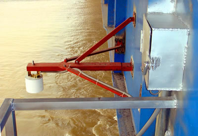

À×´ïˮλ´«¸ÐÆ÷
Ò»¡¢²úÆ·ÌØµã
²»ÊÜζȡ¢Êª¶È¡¢ÆøÑ¹¡¢ÓêÑ©ºÍ·çɳµÈ»·¾³ÒòËØµÄÓ°Ï죬²âÁ¿Ï൱Îȶ¨
·Ç½Ó´¥Ê½²âÁ¿£¬¿ÉÒÔÓÃÓڸ߸¯Ê´ÐÔÒºÌåҺλ²âÁ¿¼°ÆäËü²»ÄÜÓÃѹÁ¦Ê½´«¸ÐÆ÷²âÁ¿µÄÇé¿öÏÂ
¹¤×÷ζȷ¶Î§½Ï¿í£¬ÊÇÆÕͨ³¬Éù²¨ÒºÎ»×°ÖÃÎÞ·¨´ïµ½µÄ·¶Î§

Èý¡¢Ó¦Ó÷½°¸
    ¿ÉÓëGPRSÊý¾Ý²É¼¯Æ÷£¨i-log£©×é³Éˮλ¹Û²âϵͳ£¬Í¨¹ýGPRSÍøÂ罫¹Û²âÊý¾Ý·¢Ë͵½
Óû§Ö¸¶¨ÓÊÏ䣬·½±ã¿ì½Ý¡£
ËÄ¡¢Ó¦ÓÃÁìÓò
    ºþ²´¡¢´ó°Ó¡¢ºÓÁ÷µÈË®ÎĹ۲⡢·ÀÑ´¹¤³Ì¡¢Ë®Î»Ô¤¾¯¡¢ÎÛË®´¦Àí¡¢¸¯Ê´ÐÔÒºÌåҺλ¡¢
¹¤ÒµÒºÁÏҺλ²âÁ¿µÈÖÚ¶àÁìÓò
