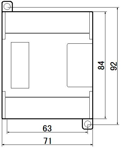

²úÆ·¸ÅÊö
G-BOX×÷ΪÎÞÏßÊý¾Ý´«ÊäͨѶģ¿é£¬²ÉÓÃModbus-TCPЭÒ飬ÓëXCϵÁÐPLCµÈ²úÆ·ÅäÌ×Ó¦ÓÃÓÚ×Ô¶¯»¯ÏµÍ³ÖÐ,ʵÏÖ×Ô¶¯»¯ÏµÍ³ÓëGPRSÍøÂ磬GSMÍøÂçµÄÎÞÏßÁ¬½Ó¡£Í¨¹ýÈí¼þXCP pro£¬¶ÔPLC½øÐÐÔ¶³Ì±à³ÌºÍÕï¶Ï£¬ÊµÏÖ³ÌÐòÉÏÏÂÔØ¹¦ÄÜ£»Í¬Ê±£¬ÊÖ»úÓû§¿Éͨ¹ýSMS¶ÌÐÅ·þÎñ¶ÔPLCʵÏÖ¿ØÖÆ£¬G-BOXÌØ±ðÊÊÓÃÓÚ·Ö²¼Ê½ÏµÍ³Ô¶³Ì¼à¿ØµÈÓ¦Óó¡ºÏ¡£
²úÆ·ÌØµã
Êý¾Ý´«Ê俪·Å͸Ã÷
ÄÚ²¿¼¯³ÉTCP/IPЭÒéÕ»µÄÊý¾Ý´«ÊäÖÕ¶Ë£¬Ö§³ÖTCP¡¢UDP¡¢DNS¡¢PPPµÈ¶àÖÖЭÒé
±ê×¼¹¤Òµ½Ó¿Ú£¨RS-232»òRS-485£©
Ö§³Ö³Ö¾ÃÔÚÏßģʽ£¬¾ßÓжÏÏßÖØ²¦ºÍÐÄÌø¹¦ÄÜ
Ö§³Ö¶ÌÐÅÊý¾ÝµÄÊÕ·¢
Ö§³Ö±¾µØÅäÖÃ
Ö§³ÖGPRSÍøÂçºÍGSMÍøÂçÁ½ÖÖͨÐÅ·½Ê½
ÊÊÓÃÁìÓò
¹¤Òµ¿ØÖÆ¡¢Ò£¸Ð¡¢Ò£²â
ÎÞÈËÖµÊØ»ú·¿¡¢²Ö¿â¼à¿Ø
¹ÜÍø¼à²â
ÓÍÌú¿óÊý¾Ý²É¼¯ºÍ¼à¿Ø
´óÐÍÉ豸µÄ¹ÊÕÏÕï¶Ï
ÆäËüÐèÒªÎÞÏßÊý¾Ý´«ÊäÓ¦Óó¡ºÏ
