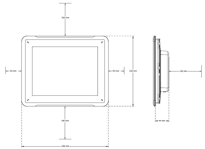

ÏÔʾÆÁ 640 x 480 pixels, 16.7 million colors (true color). TFT-LCD. LED ±³¹âµÆ
³ß´ç 10.4"
ÏÔÊ¾ÇøÓò 211.2 x 158.4 mm
ÁÁ¶È (cd/m2) 450
ÊӽǠ (H) / (V) 60/80/80/80 (ÉÏ/ÏÂ/ÓÒ/×ó)
±³¹âµÆÊÙÃü 50,000 h
´¥¿Ø´ÎÊý 100Íò´Î
LEDs 1*À¶É«LEDµÆ
Ç°Ãæ°å·À»¤µÈ¼¶ IP 65
´¦ÀíÆ÷ 400 MHz ARM9
ÄÚ´æ 80MB
Íⲿ´æ´¢Ã½½é 1*SD¿¨£¨¿ÉÑ¡£©
ʵʱʱÖÓ ÓÐ
¶î¶¨µçѹϹ¦ºÄ 400 mA
µçÔ´ +24 V DC (16-36 V DC), max 2 A.
²Ù×÷ÎÂ¶È -10¡ã C to +60¡ã C
´æ´¢ÎÂ¶È -20 to +85¡ã C
Ïà¶Ôʪ¶È ·ÇÀäÄý <95 %
ͨѶ¶Ë¿Ú ¡¡
ÒÔÌ«Íø 1 x 10 Base-T / 100 Base-T (shielded RJ 45)
USB 1 x USB Host 2.0, max output current 500 mA
°²×°³ß´ç ¡¡
Ç°Ãæ°å W x H x D 280 x 228 x 7 mm
¿ª¿×³ß´ç 262 x 209 mm
°²×°Éî¶È 44 mm
ÖØÁ¿ 1.5 kg
