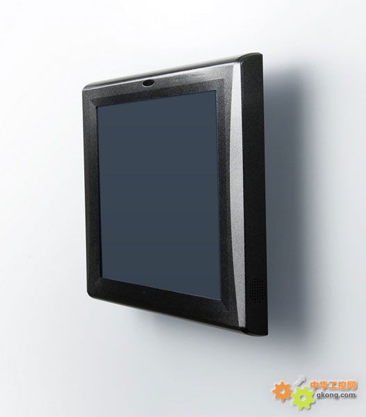

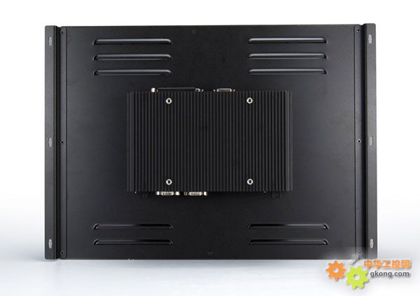

´øÓÐ15´çTFTÒº¾§ÏÔʾÆ÷ºÍ´¥ÃþÆÁµÄÎÞ·çÉÈÆ½°å¼ÆËã»ú
²úÆ·ÁÁµã
  • ÎÞ·çÉÈÉè¼Æ£¬³¬µÍ¹¦ºÄ
  • ÄÚÖÃÍþÊ¢ÐÂÒ»´ú´ø1M¶þ¼¶»º´æµÄ1.3GHz Nano™´¦ÀíÆ÷
  • ´ø5Ïßµç×èʽ´¥ÃþÆÁµÄ15" TFT LCDÃæ°å
  • ǰ¶ËÄÚÖÃ2M CMOSÉãÏñÍ·¡¢ÑïÉùÆ÷ºÍÂó¿Ë·ç
  • ¼¯³ÉÍþÊ¢Chrome9™ HC3 DX9 3D/2DͼÐκËÐļ°ÊÓÆµ´¦ÀíÆ÷£¬Ö§³ÖMPEG-2¼°WMV9ÊÓÆµ½âÂë¼ÓËÙ

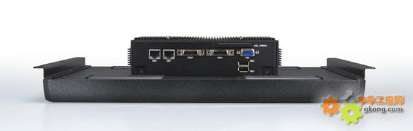

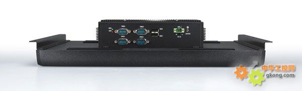

  • Ö§³ÖÁ½¸öǧÕ×ÒÔÌ«Íø¡¢ËĸöCOM¶Ë¿ÚºÍËĸöUSB 2.0¶Ë¿Ú
  • Ç°Ãæ°å·ÀË®·À³¾µÈ¼¶Âú×ãIP65ÒªÇó
ÍþÊ¢ VIPRO VP7815 ͨ¹ý DB-26 ½Ó¿Ú£¬Ö§³ÖÒ»¸öÍâÉè VGA¶Ë¿ÚºÍһ· 24bit LVDS Ðźţ¬ÍþÊ¢ VIPRO ²úƷʹÓøßÖÊ 350 cd/m2Á÷Ã÷±³¹â LED ÏÔʾÆ÷£¬·À»¤µÈ¼¶ IP65£¬ÍêÈ«Âú×ã·ÀË®·À³¾ÒªÇ󣬿ÉÌṩˮƽ 80¡ã£¬´¹Ö± 70¡ãµÄÊӽǡ£
ÌØµãÏêÇé
VIPRO VP7815ÊÇÒ»¸ö´øÓÐ 15 ´çTFTÒº¾§ÏÔʾÆ÷ºÍµç×èʽ´¥ÃþÆÁµÄÎÞ·çÉÈÆ½°åµçÄÔ£¬ÊǸ÷ÖÖ¹¤ÒµºÍÉÌÒµÓ¦ÓõÄÀíÏë½â¾ö·½°¸£¬ÌرðÊʺϸ߶˵ϧÍâÈË»ú½çÃæÓ¦Óá£Éè¼Æ¼á¹ÌÄÍÓã¬ÍþÊ¢ VIPRO VP7815 Å䱸ÁË IP65 ±ê×¼µÄ LED ±³¹âÃæ°å£¬¿É³ÐÊÜ -20¡ãC ÖÁ 60¡ãC µÄζȡ£´¥ÃþÆÁµ¼º½£¬¼¯³ÉÁË 200 ÍòÏñËØµÄ×Ô¶¯¶Ô½¹ IP ÉãÏñÍ·¡¢Âó¿Ë·çºÍÑïÉùÆ÷£¬È·±£ÁËÒµ½çÁìÏȵÄÉ豸»¥¶¯ÐÔ¡£
ʹÓÃÍþÊ¢ ART-3000 ǶÈëʽ»úÏä¹¹½¨£¬VIPRO VP7815 ÓÉ 1.3GHz ÍþÊ¢ Nano´¦ÀíÆ÷ºÍÍþÊ¢ VX800 ¶àýÌåϵͳоƬ×éÌṩ¶¯Á¦£¬ÅäÖÃÁË DX9 ¼¯³ÉÏÔ¿¨£¬ÇåÎúµÄ¸ßÇåÒôƵ£¬Ç§Õ×ÍøÂ磬Ëĸö COM ¿ÚºÍËĸö USB ¶Ë¿Ú¡£

1.3GHz Nano™ CPU Based Fanless 15¡± Resistive Touch Panel PC, with VGA, LVDS, 4 x USB 2.0, 4 x COM, 2 x GbE, Microphone, 2Mega Pixels Camera, Left/Right Speakers, DC-in 7~36V
