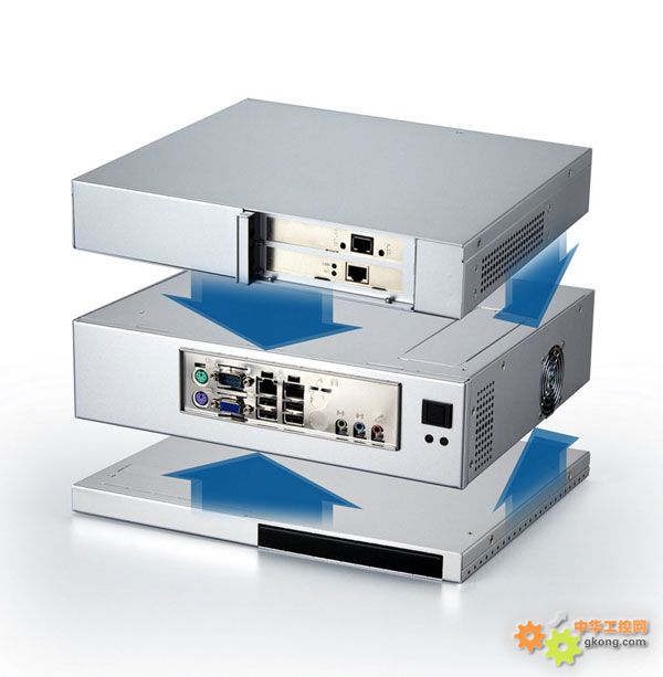

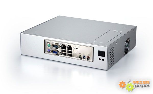

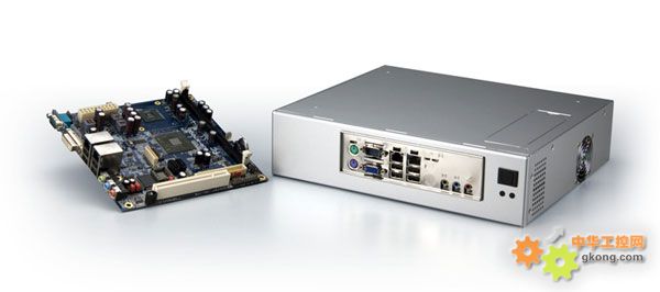

´îÔØMini-ITXǶÈëʽÖ÷°åµÄǶÈëʽϵͳ»úÏä
²úÆ·ÁÁµã
  • ÊÇÒ»¿éÖ§³ÖMini-ITXǶÈëʽÖ÷°åµÄͨÓÃСÐÍǶÈëʽ»úÏ䣻

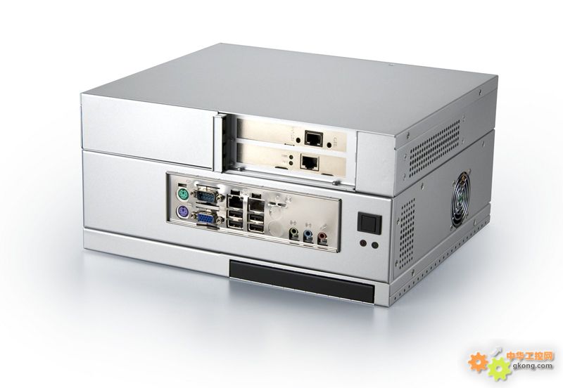

  •  ¸½¼Ó×Óϵͳ»úÏ䣬¿ÉÒÔʵÏÖPCI/PCIeת½Ó¿¨ÒÔ¼°µÚ¶þ»òµÚÈý¸öÓ²ÅÌÇý¶¯Æ÷£¬Çᱡ¹âÇý£¬CF¿¨£¬DOMµç×ÓÅ̵Ĵ洢À©Õ¹£»

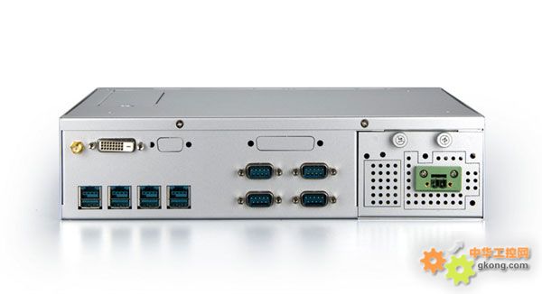

  • ¹ã·ºµÄI/OÀ©Õ¹Ö§³Ö£¬°üÀ¨£º
    • ¿É²ðжµÄǰ¶ËI/OÃæ°å£»
    • Ô¤ÁôÔÚºó¶ËI/OÃæ°åµÄ¸÷ÖÖI/O½Ó¿ÚµÄÇпڣ»
    • Ô¤Áô¸øLPC-01£¬LPC-02£¬PUSB-01¼°WLANÄ£¿éµÄ°²×°¿Õ¼ä£»
  • µçÔ´Ä£¿é»¯½á¹¹Éè¼Æ£¬¿ÉÑ¡ÓÃ120WÖ±Á÷Åäµç°å£¨Ä¬ÈÏ£©»ò1U ATXµçÔ´£¨¿ÉÑ¡£©
  • WiFiÍøÂçÑ¡Ï
  • ¶àÖØ°²×°·½°¸£º±Ú¹Ò/̨ʽ°²×°£»
  • ¿É¼æÈݵÄ×Óϵͳ»úÏ䣺ÍþÊ¢AMOS-1501£¬ÍþÊ¢AMOS-1502£»
ÌØµãÏêÇé
ÍþÊ¢AMOS-1000 Mini-ITX»úÏä¿É׼ȷÎÞÎóµØÓ븽¼Óת½Ó¼°´æ´¢Ä£¿é½øÐÐÕûºÏ£¬ÊµÏÖ¼ò±ãµÄϵͳÀ©Õ¹¼°Óû§×Ô¶¨ÒåÓ¦Óá£ÓÃÒ»¸öPCI/PCIeת½Ó¿¨£¬¼´Í¨¹ýÍþʢת½ÓÀ©Õ¹Ä£¿é¾Í¿ÉÔÚAMOS-1000Ö÷ϵͳ»úÏäÉϰ²×°ÖÚ¶àµÄ¸½¼Ó¹¦ÄÜÄ£¿é½Ó¿Ú¡£
ÍþÊ¢»úÏäÄ£¿é¿ÉʵÏÖµÚ¶þ¼°µÚÈý¸ö¸½¼Ó2.5¡± HDDµÄ°²×°£¬Æä¿Õ¼äÒ²ÕýÊʺÏÈÝÄÉÒ»¿î³¬±¡ÐÍCD/DVD ROM¹âÇý¡£¸ÃÍþʢģ¿é¿É׼ȷÎÞÎóµÄ°²×°ÔÚÍþÊ¢AMOS-100Ö÷ϵͳ»úÏäµÄÏ·½¡£
¸Ã»úÏäÅ䱸һ¸ö120WÖ±Á÷Åäµç°å£¨PWB-M120£©£¬¿É³ÐÊÜ12V-24VÖ±Á÷µçÔ´ÊäÈë¡£¿ª·¢ÈËÔ±Ò²¿ÉÑ¡Ôñ1U ATX µçÔ´¡£»ùÓÚÍþÊ¢AMOS-1000Ö÷ϵͳ¼°¿Éµþ¼ÓµÄ×Óϵͳ£¬ÍþÊ¢AMOS-1000ϵͳ²úÆ·¿ÉÌṩ³Ö¾ÃÄÍÓã¬Ò×ÓÚά»¤£¬Ê¹Ó÷½±ãµÄ»úÏ䣬ΪÓû§Ìṩ¾Þ´ó¼ÛÖµ¡£

Universal Chassis for Mini-ITX Boards, with 120W Power Board, 1 x 2.5¡± HDD Drive Bay, Reserved Cutouts of 4 x COM, 4 x USB, 1 x DVI, 1 x D-sub 9-pin I/O, 1 x Parallel, Space for 1 x WLAN USB Module

AMOS-1000-1MZZA1 with Storage Sub-system Chassis, Additional Support 2 x 2.5" HDD Drive Bay, 1 x Slim ODD Bay
AMOS-1000-1MRZA1
AMOS-1000-1MZZA1 with Riser Card Sub-system Chassis, Additional Support 2-slot PCI Card or 1-slot PCIE Card
AMOS-1000-1MSRA1
AMOS-1000-1MZZA1 with Storage and Riser Card Sub-system Chassis, Additional Support 2 x 2.5" HDD Drive Bay, 1 x Slim ODD Bay, 2-slot PCI Card
AMOS100009002-T
Embedded Chassis (AMOS-1000-1MZZA1) with EPIA-M700 (1.5GHz VIA C7®)
AMOS100009003-T
Embedded Chassis (AMOS-1000-1MZZA1) with EPIA SN (1.0GHz VIA C7®)
AMOS100009004-T
Embedded Chassis (AMOS-1000-1MZZA1)  with EPIA EX (1.5GHz VIA C7®)
AMOS100009005-T
Embedded Chassis (AMOS-1000-1MZZA1)  with EPIA EN (1.5GHz VIA C7®)
AMOS100009006-T
Embedded Chassis (AMOS-1000-1MZZA1) with VB8001(1.6GHz VIA Nano™)
