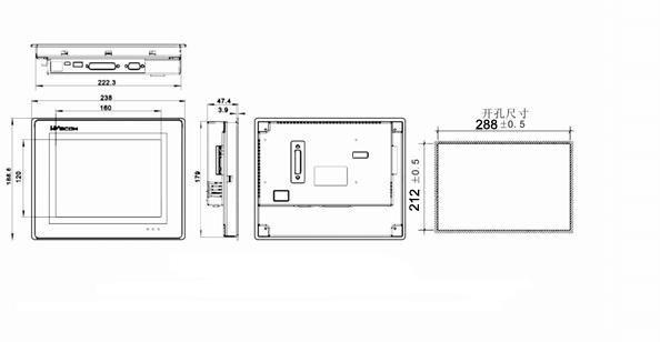

ÍâÐγߴç
299.0W×222.0H× 54.0Dmm
°²×°¿ª¿×³ß´ç
288.0W× 212.0Hmm
