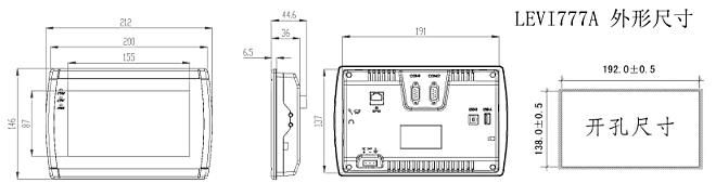

ÍâÐγߴç
212W¡Á146.0H¡Á 36.0Dmm
°²×°¿ª¿×³ß´ç
192W¡Á 138Hmm
