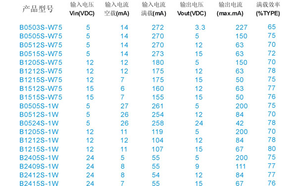

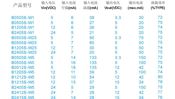

²úÆ·Ãû³Æ£º RS485½Ó¿ÚDC-DC¸ôÀëÖ±Á÷µçÔ´Ä£¿é
ÐÍ ºÅ£º BXXXXS-W1/1W¡¡B0505S-1W B0503S-1W
B SϵÁС¡BXXXXS-W1/1W¡¡¡¡1KVAC¸ôÀë¡¡¡¡0.1W ¡«1W¡¡¡¡ ·ÇÎÈѹµ¥Êä³ö ¡¡¡¡
BXXXXS-W1/1W DC-DCÄ£¿éµçÔ´Ö÷ÒªÓÃÓÚRS232/485¡¢CAN×ÜÏßµÈÊý×Ö½Ó¿ÚµçÔ´¸ôÀë¡£ÔÚ°²·À¿ìÇò¼à¿Ø¡¢¼ÆËã»ú485½Ó¿ÚÖÇÄÜ¿ØÖƵÈÐÐÒµ¹ã·ºÓ¦Óá£
ÊäÈëµçѹ¡¡¡¡¡¡¡¡¡¡¡¡¡¡¡¡¡¡¡¡
5V / 9V / 12V / 15V / 24V DC
Êä³öµçѹ
3.3V / 5V / 9V / 12V / 15V / 24V DC
ÈçÐèÆäËü¹æ¸ñ,Çë×Éѯ˳Դ¿Æ¼¼¹«Ë¾

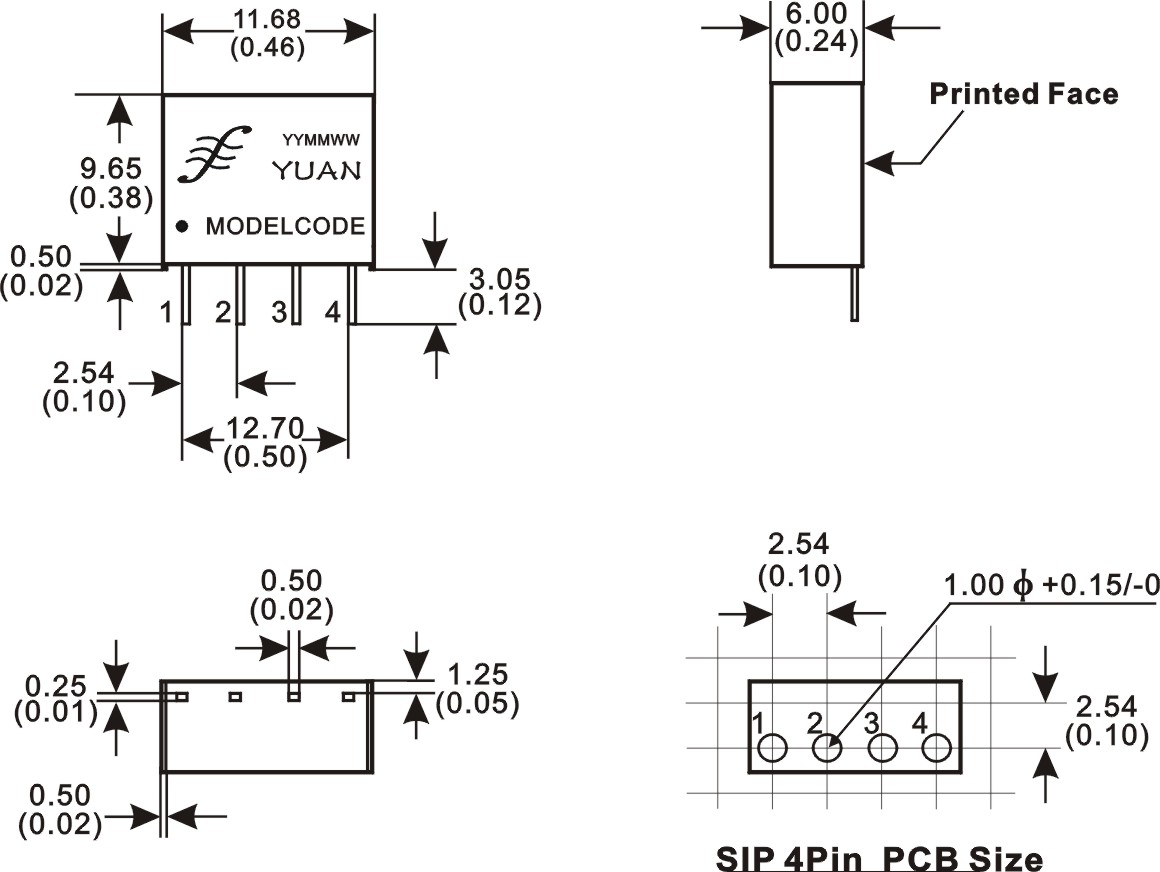

Ìå»ýÌØÐÔ
SIP ·â×°³ß´ç¡¡¡¡¡¡¡¡¡¡¡¡¡¡¡¡¡¡¡¡¡¡¡¡¡¡¡¡¡¡¡¡¡¡¡¡11.68 x 6,00 x 10,16 mm
¡¡¡¡¡¡¡¡¡¡¡¡¡¡¡¡¡¡¡¡¡¡¡¡¡¡¡¡¡¡¡¡¡¡¡¡¡¡¡¡¡¡¡¡¡¡¡¡0,46 x 0,24 x 0,40Ó¢´ç
ÖØÁ¿ ¡¡¡¡¡¡¡¡¡¡¡¡¡¡¡¡¡¡¡¡¡¡¡¡¡¡¡¡¡¡¡¡¡¡¡¡¡¡ 2 g~3 g
Íâ¿Ç²ÄÁÏ ¡¡¡¡¡¡¡¡¡¡¡¡¡¡¡¡¡¡¡¡¡¡¡¡¡¡¡¡¡¡¡¡·Ç´«µ¼×èȼºÚËÜÁÏ
