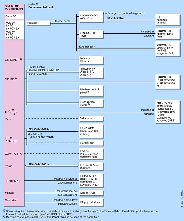

Î÷ÃÅ×ÓPCU50
¸ßÐÔÄÜÐÍ SINUMERIK PCU 50 ¾ßÓÐÄÚÖýӿڣ¬¿ÉÒÔͨ¹ýÒÔÌ«Íø¡¢ MPI ºÍ PROFIBUS DP ½øÐÐͨѶ£¬ËüÁô³ö¼¯³ÉµÄ¿Õ²Û¸øÆäËü¿¨¼þ¡£É豸ºóÃæµÄ USB ¿ÚΪ±ê×¼µÄ PC ¼üÅ̺ÍÊó±êÌṩ¡°¼´²å¼´ÓᱵŦÄÜ¡£ SINUMERIK PCU 50 Å䱸 Windows XP ProEmbSys ²Ù×÷ϵͳ£¬¶ÔÓÚ±¸·ÝºÍ»Ö¸´Êý¾Ý£¬ ÓÐ Ghost 6 ºÍ Ghost 7 Êý¾Ý±¸·ÝÈí¼þ¡£
HMI-Advanced ¸ß¼¶Èí¼þ¿ÉÒÔµ¥¶À¶©»õ¡£
"SINUMERIK Service Pack Recovery Media WIN XP ProEmbSys" ÓÃÓÚʹÓà Windows XP ProEmbSys ²Ù×÷ϵͳµÄ PCU£¬¿ÉÓÃÓÚÖØ а²×° Windows Èí¼þ²¿¼þ£¬»Ö¸´³ö³§Ê±µÄÉèÖá£
Design
  • ȫРIntel ¼¼Êõ 1.2 GHz/256 MB »òÕß 1.2 GHz/512MB
  • ²ÉÓÃÔËÊä»ú¹¹µÄ¿É¸ü»»Ó²ÅÌ,40GB
    12 GB ÓÃÓÚÓ¦Óà (HMI-Advanced, MCIS Èí¼þ) ºÍÊý¾Ý±£´æ(¹¤¼þ³ÌÐò, Îĵµ, ÆäËûÊý¾Ý)
    15 GB ÓÃÓÚ±¾µØ±¸·ÝºÍ°²×°Èí¼þ
  • ×î´ó´æ´¢Æ÷ÅäÖà 512 MB£¬°üÀ¨Í¼ÐÎÄÚ´æ
  • ͼÐλ¯ÏÔʾ£º UXGA LCD ¿ØÖÆÆ÷£¬AGP ×ÜÏߣ» 8¡¢16 »ò 32 MB£¬ ¿Éͨ¹ý BIOS ÅäÖã»Í¼ÐÎÄÚ´æÈ¡×ÔÖ÷´æ´¢Æ÷
  • Windows XP ProEmbSys ²Ù×÷ϵͳ
  • ÀûÓà Ghost Êý¾Ý±¸·ÝÈí¼þ½øÐÐÊý¾Ý±¸·Ý / »Ö¸´
  • ¶Ë¿Ú£º
    • ÒÔÌ«Íø 10/100 Mbit/s (RJ45)
    • USB£¬ 2 ½Ó¿Ú£¨1 x ÄÚ²¿½Ó¿Ú/2 x ÍâÄÚ²¿½Ó¿Ú£©USB1.1
    • COM 1 (V.24), COM 2 (V.24), LPT 1, VGA
    • PS/2 ¼üÅÌ
    • PS/2 Êó±ê
    • MPI ½Ó¿Ú
    • ÍâÖÃÈíÇý
  • À©Õ¹²å²Û£º
    • 1 x 3/4 PCI £¬³¤ 265 mm(10.43in)
    • 1 x PCI/ISA£¨¹²Óã©£¬ 170 mm(6.69in)
    • 1 x PC ¿¨£¬ III ÐÍ
×¢£º
SINUMERIK PCU 5 ½»»õʱÎÞ°²×°¼ÜÇëÔÚ¶©¹ºÊ±Ó¦ËµÃ÷°²×°Ö§¼Ü¡£
Integration
SINUMERIK PCU 50 ¿ÉÓÃÓÚ:
  • SINUMERIK 810D powerline/840Di/840D powerline
SINUMERIK PCU 50 Á¬½Ó¸ÅÀÀ
