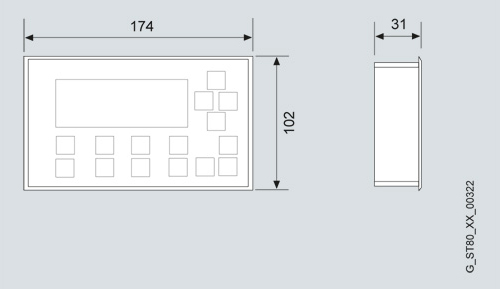

Dimensional drawings
ËùÓÐÍâÐγߴç¾ùÒÔºÁÃ×Ϊµ¥Î»¡£Óйذ²×°ÇпڵÄÏêϸÐÅÏ¢£¬Çë²Î¼û¼¼Êõ¹æ·¶¡£
TD400C
