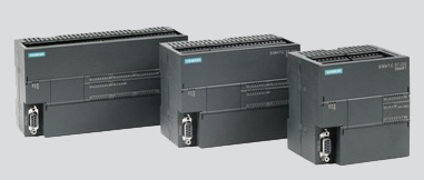

²úÆ·Ãû³Æ£º Î÷ÃÅ×ÓCPUST40
ÐÍ ºÅ£º 6ES7 288-1ST40-0AA0
Æ· ÅÆ£º 1
ÐͺÅ
CPU ST40 DC/DC/DC
CPU ST60 DC/DC/DC
¶©»õºÅ£¨MLFB£©
6ES7 288-1ST40-0AA0
