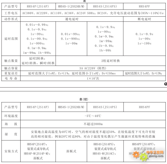

¶þ¡¢ÐÀÁéÊý×Öʽʱ¼ä¼ÌµçÆ÷ HHS4P 99s AC380V ͨµçÑÓʱJS14PµÄ¸Ä½ø¿îÖ÷Òª¼¼ÊõÊý¾Ý£º
¹¤×÷µçÔ´£ºDC24V¡¢AC220V¡¢AC380V
ÑÓʱ·¶Î§£º0.99S¡¢9.9S¡¢99S¡¢9.9M¡¢ 99M¡¢9.9H¡¢99H
ÖØ¸´Îó²î£º≤1%
¹¤×÷ģʽ£ºÍ¨µçÑÓʱ
´¥µãÊýÁ¿£º2×éÑÓʱת»»´¥µã
´¥µãÈÝÁ¿£ºAC220V 3A(×èÐÔ)
ÍâÐγߴ磺104×52×114mm
¿ª¿×³ß´ç£º77×45 mm
°²×°·½Ê½£ºÃæ°åʽ

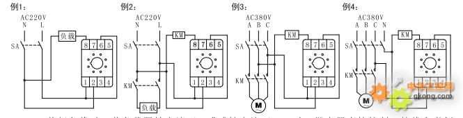

Èý¡¢ÐÀÁéÊý×Öʽʱ¼ä¼ÌµçÆ÷ HHS4P 99s AC380V ͨµçÑÓʱJS14PµÄ¸Ä½ø¿îÓ¦Óõç·¾ÙÀý£º
1.µ¥Ïà¸ºÔØÊ±£¬Èô¸ºÔØ×èÐÔµçÁ÷СÓÚµÈÓÚ3A»ò¸ÐÐÔµçÁ÷СÓÚµÈÓÚ0.5Aʱ£¬¼ÌµçÆ÷Ö±½Ó¿ØÖÆ£¬½ÓÏ߲ο¼Àý1£»Èô¸ºÔØ×èÐÔµçÁ÷´óÓÚ3A»ò¸ÐÐÔµçÁ÷´óÓÚ0.5Aʱ£¬¼ÌµçÆ÷ͨ¹ý½»Á÷½Ó´¥Æ÷À©ÈÝ£¬½ÓÏ߲ο¼Àý2;ÈýÏà¸ºÔØÊ±£¬½»Á÷½Ó´¥Æ÷ºÍ¼ÌµçÆ÷µçԴΪAC380Vʱ£¬½ÓÏ߲ο¼Àý3£»½»Á÷½Ó´¥Æ÷ºÍ¼ÌµçÆ÷µçԴΪAC220Vʱ£¬½ÓÏ߲ο¼Àý4.
2.ʾÀý¼ÌµçÆ÷ËùÆðµÄ¹¦ÄÜΪ£ºµ±½ÓͨµçԴʱ£¬¸ºÔØ»òKM£¨½»Á÷½Ó´¥Æ÷£©µÃµç£¬¾­ÑÓʱµ½Ô¤ÖÃֵʱ£¬¸ºÔØ»òKM£¨½»Á÷½Ó´¥Æ÷£©Ê§µç¡£
×¢1£º¸ºÔØ¿ÉΪ·µÆ»òµÆÅÝ£¬¿ÉÖ±½Ó½ÓÔÚ·µÆ»òµÆÅݶ˿ڵÄÁ½¸ùÏßÉÏ£¨ÈçÀý1Ëùʾ£©¡£
×¢2£ºKMΪ½»Á÷½Ó´¥Æ÷µÄÏßȦ£¬A1¡¢A2Á½¶Ë¿É°´Àý2¡¢Àý3¡¢Àý4½ÓÏß¡£
×¢3£ºÀý3Öеļ̵çÆ÷¼°KMµÄ¹¤×÷µçÔ´¾ùΪAC380V,ӦעÒâËùÑ¡ÓòúÆ·µÄµçѹµÈ¼¶¡£
