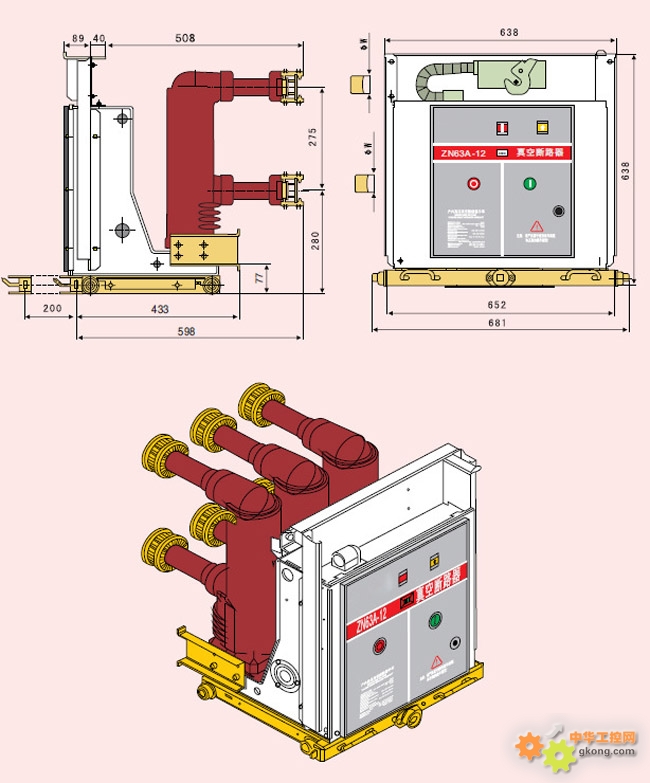

ZN63-12(VS1)ÐÍ»§ÄÚ¸ßÑ¹Õæ¿Õ¶Ï·Æ÷

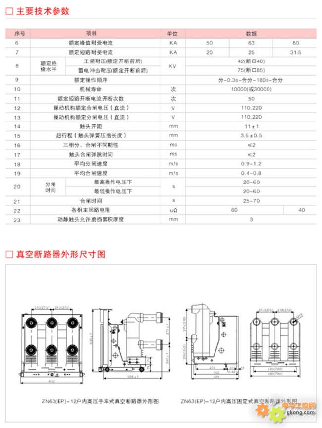

1.²úÆ·Ðͺż°Ãû³Æ
VS1(ZN63)-12/630-20
VS1(ZN63)-12/630-25
VS1(ZN63)-12/1000-20
VS1(ZN63)-12/1000-25
VS1(ZN63)-12/1250-20
VS1(ZN63)-12/1250-25
VS1(ZN63)-12/1250-31.5
VS1(ZN63)--12/1600-31.5
VS1(ZN63)-12/1600-31.5
VS1(ZN63)-12/2000-31.5
VS1(ZN63)-12/2000-40
VS1(ZN63)-12/2500-31.5
VS1(ZN63)-12/3150-40

¶Ï·Æ÷Ö÷Ìå½á¹¹
1. ÆÕͨÐÍ
    ¶Ï·Æ÷Ö÷Ì岿·Öµ¼µç»ØÂ·ÉèÖÃÔÚÓþøÔµ²ÄÁÏÖÆ³ÉµÄÔ²Öù×´¾øÔµÍ²ÄÚ£¬Ê¹µÃÕæ¿ÕÃð»¡ÊÒÃâÊÜÍâ½ç»·¾³Ó°ÏìºÍ»úеµÄË𺦡£¶Ï·Æ÷Ö÷Ìå°²×°ÔÚ×ö³ÉÍмÜ×´µÄ¶Ï·Æ÷²Ù¶¯»ú¹¹Íâ¿ÇµÄºó²¿¡£ÊÓʹÓó¡ËùÇé¿ö£¬¿ÉÔÚ¾øÔµÍ²ÉÏÔö×°Ò»¸ö·À³¾¸Ç(×÷Ϊ¸½¼Ó×°ÖÃ)£¬ÕâÖÖÉè¼ÆÓÐÖúÓÚ·ÀÖ¹ÉÁÂçµÄ·¢Éú£¬²¢×÷Ϊ¶Ï·Æ÷ÄÚ²¿ÎÛ»àµÄ¸½¼Ó±£»¤¡£
2. ¼«ÖùÐÍ
    ¶Ï·Æ÷¼«ÖùÉè¼ÆÎªÔ²ÖùÐΣ¬°²×°ÔÚÍмÜ×´µÄ²Ù×÷»ú¹¹Íâ¿ÇµÄºó²¿¡£¶Ï·Æ÷¼«ÖùµÄµ¼µç²¿·Ö·â±ÕÔÚ»·ÑõÊ÷Ö¬Ì×ͲÄÚ£¬ÒÔÃâÊܳå»÷ºÍÍⲿ»·¾³Ó°Ïì¡£
²Ù¶¯»ú¹¹µÄ½á¹¹
    ²Ù¶¯»ú¹¹Îªµ¯»É´¢ÄܲÙ×÷»ú¹¹£¬Ò»Ì¨²Ù¶¯»ú¹¹²Ù×÷ÈýÏàÕæ¿ÕÃð»¡ÊÒ¡£²Ù¶¯»ú¹¹Ö÷Òª°üÀ¨Á½¸ö´¢ÄÜÓÃÀ­É쵯»É¡¢ºÏÕ¢´¢ÄÜ×°Öᢴ«¶¯ÖÁ¸÷ÏàÃð»¡ÊÒµÄÁ¬°å¡¢¹Õ±ÛÒÔ¼°·ÖÕ¢ÍÑ¿Û×°Ö㬴ËÍ⣬ÔڸܼÜǰ·½»¹×°ÓÐÖîÈç´¢Äܵ綯»ú¡¢ÍÑ¿ÛÆ÷¡¢¸¨Öú¿ª¹Ø¡¢¿ØÖÆÉ豸¡¢·ÖºÏÕ¢°´Å¥¡¢ÊÖ¶¯´¢ÄÜÖá¡¢´¢ÄÜ×´Ì¬Ö¸Ê¾ÅÆ¡¢ºÏ·ÖÕ¢Ö¸Ê¾ÅÆµÈ²¿¼þ¡£
²Ù¶¯»ú¹¹ÊÊÓÃÓÚ×Ô¶¯ÖغÏÕ¢µÄ²Ù×÷£¬²¢ÇÒ£¬ÓÉÓڵ綯»ú´¢ÄÜʱ¼äºÜ¶Ì£¬Í¬ÑùÒ²Äܹ»½øÐжà´ÎÖØºÏÕ¢²Ù×÷¡£
²Ù¶¯»ú¹¹µ¯»ÉÓÐÊÖ¶¯´¢Äܺ͵綯´¢ÄÜÁ½ÖÖ´¢ÄÜ·½Ê½¡£
