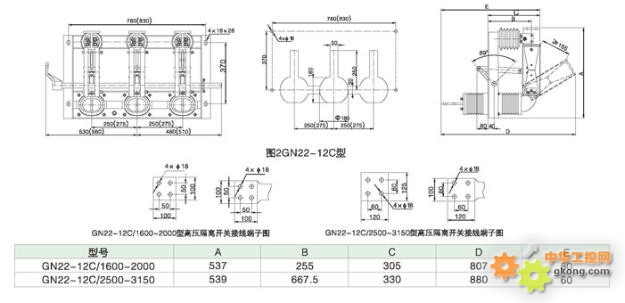

Ò»¡¢¸ÅÊö
    GN22-12( C )£¨D£©ÏµÁл§ÄÚ¸ßѹ½»Á÷¸ôÀ뿪¹Ø£¨ÒÔϼò³Æ¸ôÀ뿪¹Ø£©Îª¶î¶¨µçѹ12kV£¬ÈýÏཻÁ÷50HzµÄ»§ÄÚ×°Öã¬×÷ΪÓеçѹ¶øÎÞ¸ºÔصÄÇé¿öÏ·֡¢ºÏµç·֮Óá£
GN22-12ϵÁл§ÄÚ¸ßѹ½»Á÷¸ôÀ뿪¹Ø±¾²úÆ··ûºÏGB1985-2004¡¢GB/T11022-1999µÄ¹æ¶¨¡£
¶þ¡¢½á¹¹¼ò½é
    GN22-12ϵÁл§ÄÚ¸ßѹ½»Á÷¸ôÀ뿪¹ØÎªÈý¼«Ê½Á½²½¶¯×÷½á¹¹¡£Ö÷ÒªÓɵ׼ܡ¢´«¶¯²Ù×÷¸Ë¡¢´¥µ¶¡¢´¥×ù¡¢´ÅËø°åµÈ×é³É£»µ×¼ÜÓɽǸּ°¸Ö°åº¸½Ó¶ø³É£¬²¢×°ÓÐתÖáÁ¬°åµÈ£¬ÆäÏà¼ä¾àÀë·Ö250mm¡¢275mmºÍ380mm£¨5000A¡¢6300AרÓУ©£¬µ¼µç²¿·Ö´¥×ùΪÕûÌå³ÉÐΣ¬Æä½ÓÏß¶Ë×ÓÓëĸÏßÏàÁ¬£¬´¥µ¶Îª²ÛÐÎÒÔÌá¸ßÆä»úеǿ¶È¼°µçÆøÐÔÄÜ£»´ÅËø°åÔÚ´¥µ¶Á½²àÔö¼ÓÆä½Ó´¥Ñ¹Á¦£»´«¶¯²Ù×÷¸Ë϶ËÓëµ×¼ÜתÖáÏàÁ¬£¬É϶ËÓë´¥µ¶Ëø½ô»ú¹¹ÏàÁ¬½Ó
Èý¡¢ Ê¹Óû·¾³Ìõ¼þ
 1¡¢º£°Î£º²»³¬¹ý1000m£»
 2¡¢ÖÜΧ¿ÕÆøÎ¶ȣº-30¡æ¡«+40¡æ£»
 3¡¢ÖÜΧ»·¾³Ïà¶Ôʪ¶È£ºÈÕÆ½¾ùÖµ²»´óÓÚ95%£¬ÔÂÆ½¾ùÖµ²»´óÓÚ90%£»
 4¡¢µØzhenÁҶȲ»³¬¹ý8¶È£»
 5¡¢°²×°³¡Ëù£ºÃ»ÓлðÔÖ¡¢Ò×ȼ¡¢Ò×±¬¡¢ÑÏÖØÎۻࡢ»¯Ñ§¸¯Ê´¼°¾çÁÒÕñ¶¯³¡Ëù¡£
ËÄ¡¢ ¼¼Êõ²ÎÊý¼°°²×°³ß´ç
