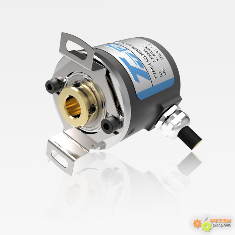

²úÆ·Ãû³Æ£º ÍÐ·Æ ESG38BÔöÁ¿Ê½±àÂëÆ÷
ÐÍ ºÅ£º ESG38B
ESG38BϵÁÐ
¸ÐÓ¦Ô­Àí ¹âµç
Íâ¾¶ Φ38mm
°ë¿ÕÐÄÖá Φ5¡¢Φ6¡¢Φ8mm
×î´óÂö³å2500PPR
¹¤×÷µçѹ5VDC£¬5-30VDC£¬9-26VDC
·À»¤µÈ¼¶IP54
ÌØµã£ºË«Òíµ¯»ÉƬ¸½¼þ°²×°ÈáÐÔÁ¬½Ó±ÜÃâ¶Ô±àÂëÆ÷µÄÖ±½ÓËðÉË£¬½ðÊôÍâ¿ÇºÍ½ðÊô·ÀË®½ÓÍ·¾ßÓп¹³å»÷ºÍ¸ß·À»¤ÐÔÄÜ£¬ µç·¿íµçѹ¹©µç²¢¾ßÓз´½Ó±£»¤ºÍ¶Ì·±£»¤¹¦ÄÜ¡£
Ó¦ÓãºÐ¡Ð;­¼ÃÖáÌ×ÐÍESG38B±àÂëÆ÷¹ã·ºÓ¦ÓÃÓÚÇṤÐÐÒµ£¬ÓÈÆäÊÇÔÚÓ¡Ë¢°ü×°ÐÐÒµ¿ØÖÆÓ¦ÓÃÖиüΪͻ³ö¡£ ESG38BÐͱàÂëÆ÷Ìå»ýС¡¢ÖØÁ¿Çá¡¢¾«¶È¸ß£¬ÖáÌ×ÐÍÉè¼Æ½ÚÔ¼Á˰²×°¿Õ¼äºÍ³É±¾£¬ÊÇÐԼ۱ȽϸߵÄÓÅÑ¡²úÆ·¡£
¼¼Êõ²ÎÊý
³öÖ᷽ʽ °ë¿ÕÐÄÖá
¸ÐÓ¦Ô­Àí ¹âµçʽ
Âö³å/Ȧ ≤2500PPR
µçÔ´µçѹ
5VDC
9-26VDC
5-30VDC
ÏûºÄµçÁ÷ £¼125mA
ÏìӦƵÂÊ £¼300KHz
Öá¾¶ Φ5¡¢Φ6¡¢Φ8mm
·À»¤µÈ¼¶
IP54
ÿ·ÖÖÓ×î´óתËÙ 6000RPM
×î´óÖḺºÉ 25N Axial;50N Radial
Æô¶¯Á¦¾Ø <0.005Nm
Öá²ÄÁÏ Í­
Íâ¿Ç²ÄÁÏ À­ÉìÌú¿Ç+ºÚÉ«ÅçÍ¿
¹¤×÷ÎÂ¶È -20~+70¡æ
´¢´æÎÂ¶È -30~+85¡æ
ÖØÁ¿ ≈120g
¿ÉÑ¡¸½¼þ Ë«Òíµ¯ÐÔÖ§¼Ü8121
