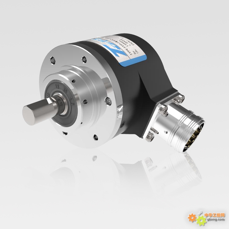

²úÆ·Ãû³Æ£º ÍÐ·Ç EDG58SÔöÁ¿Ê½±àÂëÆ÷
ÐÍ ºÅ£º EDG58S
EDG58SϵÁÐ
¸ÐÓ¦Ô­Àí ¹âµç
Íâ¾¶ Φ58mm
ʵÐÄÖá Φ6¡¢Φ8¡¢Φ10mm
×î´óÂö³å5000PPR
¹¤×÷µçѹ5VDC£¬5-30VDC£¬9-26VDC
·À»¤µÈ¼¶IP65/IP67
¼¼Êõ²ÎÊý
³öÖ᷽ʽ ʵÐÄÖá
¸ÐÓ¦Ô­Àí ¹âµçʽ
Âö³å/Ȧ ≤5000PPR
µçÔ´µçѹ
5VDC
9-26VDC
5-30VDC
ÏûºÄµçÁ÷ £¼125mA
ÏìӦƵÂÊ £¼300KHz
Öá¾¶ Φ6¡¢Φ8¡¢Φ10mm
·À»¤µÈ¼¶
IP65/IP67
ÿ·ÖÖÓ×î´óתËÙ 6000RPM
×î´óÖḺºÉ 40N Axial;80N Radial
Æô¶¯Á¦¾Ø <0.015Nm
Öá²ÄÁÏ ²»Ðâ¸Ö
Íâ¿Ç²ÄÁÏ ÂÁºÏ½ð
¹¤×÷ÎÂ¶È -20~+70¡æ
´¢´æÎÂ¶È -40~+85¡æ
ÖØÁ¿ ≈350g
¿ÉÑ¡¸½¼þ ÁªÖáÆ÷8212B 10-10¡¢8215 10-10£¬Æ«ÐÄÁ¬½ÓÆ÷8531
Ó¦ÓãºÊµÐÄÖá±àÂëÆ÷EDG58SϵÁУ¬±ê×¼µÄ¹¤ÒµÓõäÐͲúÆ·£¬½á¹¹½ô´ÕºÏÀí£¬ÄܳÐÊܽϸߵÄÖáÏòÔØºÉºÍ¾¶ÏòÔØºÉ¡£ »úе½á¹¹ºÍµçÆøÏß·Éè¼ÆµÄÁé»îÐÔ£¬¿ÉÓë¸÷ÖÖ½ÓÊÕÆ÷»ò¼ÆÊýÆ÷ÅäºÏʹÓᣠIP67µÄ¸ß·À»¤µÈ¼¶ÔÚ½ÏΪ¶ñÁÓ»·¾³Öеõ½¹ã·ºÓ¦Óã¬ÊÇÐԼ۱ȽϸߵIJúÆ·¡£
ÌØµã£ºÑô¼«Ñõ»¯´¦ÀíµÄÂÁºÏ½ðÍâ¿ÇºÍÂÁºÏ½ðÖ÷Ì壬¾ßÓиü¸ßµÄ¿¹³å»÷ºÍ¿¹¶ñÁÓ»·¾³ÄÜÁ¦¡£ ½ðÊô·ÀË®½ÓÍ·¼°µçÆø²å×ù¾ßÓи߷À»¤ÐÔÄÜ£¬²»Ðâ¸ÖÖ÷Öá¾ßÓиü¸ßµÄÎȶ¨ÐԺ͸ºÔØÄÜÁ¦£¬ ¹«¡¢Ó¢ÖÆ·¨À¼³ß´ç·½±ã¿Í»§µÄ°²×°Ó¦Ó㬵緿íµçѹ¹©µç²¢¾ßÓз´½Ó±£»¤ºÍ¶Ì·±£»¤¹¦ÄÜ¡£
