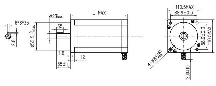

²úÆ·Ãû³Æ£º »ìºÏʽ²½½øµç»ú
ÐÍ ºÅ£º HYBRID STEPPER MOTOR-NEMA42
Details
Electrical Specification£º
Model
step angel
º
Motor Length
mm
Voltage
v
Current
A
Resistance
Ω
Inductance
Mh
Hording torque
N.m
Detent Torque
N.m
Rotor Inertia
g.cm2
Lead Wires
Weight
KG
42HS9460
1.8
100
4.95
6.0
0.9
12
11.2
3
5500
4
5
42HS5460
1.8
150
5.2
6.0
0.8
15
21
5.9
10900
4
8.4
42HS6480
1.8
201
8
8.0
1
16
28
9.5
16200
4
11.7
