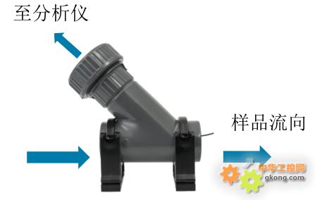

4¡¢¶ÀÌØµÄY-strainerÉè¼Æ£¬ÇáËÉʵÏÖÔ¤´¦Àí£¬ÈçÏ£º
(1)²ÉÑù¹ÜλÓڹܵÀÖÐÑ룬³éÈ¡´ú±íÐÔË®Ñù£»
(2)˳·½ÏòµÄ°Ú¶¯ºÍ×Ô³åË¢£¬±£Ö¤²ÉÑù¹Ü²»±»¶ÂÈû£»
(3)·½±ãµÄ¹ý³ÌÁ¬½Ó-±ê×¼40mmÕ³ºÏ½ÓÍ·£»
(4)²ÉÑù¹ÜÄÚ¾¶£º0.8mm£¬·ûºÏ¹ú¼ÒÒªÇó£»
(5)ά»¤·½±ã
