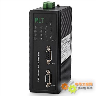

²úÆ·Ãû³Æ£º ÈñÁ¦Í¨¿Æ¼¼¹¤Òµ¼¶MODBUS×ÜÏ߸ôÀëÖÐ¼ÌÆ÷
ÐÍ ºÅ£º RT-HM2
¸ÅÊö£º
     ±¾²úÆ·ÊÇÒ»¿îMODBUSÏÖ³¡×ÜÏßÖÐ¼ÌÆ÷£¬·ûºÏMODBUSЭÒé±ê×¼£¬2·¶ÀÁ¢×ÜÏßµç½Ó¿Ú£¬Êý¾Ýȫ͸Ã÷´«Ê䣬×Ô¶¯Çл»Êý¾Ý·½Ïò£¬ËÙÂÊ×ÔÊÊÓ¦£¬Ö§³ÖMODBUS×ÜÏßÈ«²¿ËÙÂÊ¡£¸Ã²úÆ·Äܹ»ÑÓ³¤MODBUS×ÜÏߵĴ«Êä¾àÀ룬¸Ä±ä×ÜÏßÍØÆË½á¹¹£¬Í¬Ê±¾ßÓйâñî¸ôÀë¡¢¼õÉÙ¸ÉÈŵÈÐÔÄÜ¡£
±¾²úƷΪ¹¤Òµ¼¶Éè¼Æ£¬¾ßÓпíµçÔ´DC£¨12-36V£©ÊäÈ룬µçÔ´ÈßÓàºÍ¸ôÀë±£»¤£¬¼ÌµçÆ÷¸æ¾¯Êä³ö£¬IP40·À»¤µÈ¼¶£¬²¨ÀËÎÆÂÁÖÆ¼ÓÇ¿»ú¿Ç£¬35mmDINµ¼¹ì°²×°£¬-40~85¡æ¹¤×÷ζȷ¶Î§µÈÓŵ㣬ÄÜÂú×ã¸÷ÖÖ¹¤ÒµÏÖ³¡µÄʹÓÃÒªÇó¡£
²úÆ·ÌØµã£º
  1. 2·¶ÀÁ¢MODBUS×ÜÏßµç¿Ú
  2. 2·µç¿Ú¹âñî¸ôÀ룬¸ôÀëµçѹ1000V£¬1500W·ÀÀ×±£»¤¹¦ÄÜ
  3. Ö§³ÖMODBUS×ÜÏßÈ«²¿ËÙÂÊ£¨0~500kBit/s£©£¬Í¸Ã÷´«Ê䣬ËÙÂÊ×ÔÊÊÓ¦
  4. Ö§³Öµã¶ÔµãÍØÆË½á¹¹
  5. Ìṩ6¸öLED״ָ̬ʾµÆ£¬×ÜÏßÊý¾Ý½Ó¿Ú¼ÌµçÆ÷¸æ¾¯Êä³ö
  6. DC24V ÈßÓàµçÔ´£¬¸ôÀëµçѹ1500V,1AµçÁ÷±£»¤£¨¶Ì·±£»¤£¬£©Ö§³Ö·´½Ó±£»¤¹¦ÄÜ
  7. ²¨ÎÆÊ½¸ßÇ¿¶È½ðÊôÍâ¿Ç£¬IP40·À»¤µÈ¼¶, DIN35mm¹¤Òµ¿¨¹ì°²×°

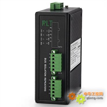

¼¼Êõ²ÎÊý
µç½Ó¿Ú£º
  1. ½Ó¿ÚÀàÐÍ£ºDB9Fµç¿Ú»ò¹¤Òµ5PIN¶Ë×Ó
  2. ͨÐÅËÙÂÊ£º0~500kBit/s£¬ËÙÂÊ×ÔÊÊÓ¦
  3. ÐźÅÑÓʱ£¨µç¿Ú£©£º100ns
  4. 2·µç¿Ú¹âñî¸ôÀ룬¸ôÀëµçѹ1000V£¬1500W·ÀÀ×±£»¤¹¦ÄÜ
  5. ±¾»ú²»´øÖն˵ç×裬Çë°´ÐèÒªÍâ½Ó
µçÔ´¼°±£»¤£º
  1. Ë«µçÔ´ÈßÓàÊäÈ룬DC12V-36VÖµ£¬µäÐÍÖµDC24V£¬¸ôÀëµçѹ1500V,1AµçÁ÷±£»¤(µçÁ÷¶Ì·±£»¤)£¬·´½Ó±£»¤¹¦ÄÜ
  2. ¹¤×÷µçÁ÷µäÐÍÖµ60mA@24V
  3. µç¿Ú¹ÊÕϸ澯Êä³ö£¬´¥µãÈÝÁ¿£ºDC24V/1A
¹¤×÷»·¾³£º
  1. ²Ù×÷ζȣº
±ê×¼ÀàÐÍ£º0 ~ 70 °C
¿íÎÂÀàÐÍ£º-40 ~ 85 °C
²Ù×÷ʪ¶È£º5  ~ 95% RH
  1. ´æ·Åζȣº -40 ~ 85 °C
»úÐµÌØÐÔ£º
  1. ÍâÐγߴ磺138mm×106mm×54mm
  2. Íâ¿Ç£ºIP40·À»¤µÈ¼¶,ÂÁÖÆ¼ÓÇ¿»ú¿Ç
  3. °²×°·½Ê½£º 35mmDINµ¼¹ì°²×°
  4. ¾»ÖØ£º800g
·ûºÏ±ê×¼£º
  1. EMI£ºEN55022 1998, Class A
  2. EN61000-4-2 (ESD), Criteria B, Level 4
  3. EN61000-4-3 (RS), Criteria A, Level 2
  4. EN61000-4-4 (EFT), Criteria B, Level 4
  5. EN61000-4-5 (Surge), Criteria B, Level 2
  6. EN61000-4-6 (CS), Criteria B, Level 2
  7. En61000-4-8 (PFMF), Criteria A, Level 3
  8. IEC60068-2-27
  9. EN50121-4
  10. Freefall£ºIEC 60068-2-32
Ó¦Ó÷¶Î§£º
µçÁ¦¡¢½»Í¨¡¢ÄÜÔ´¡¢³§¿ó¡¢¼à¿Ø¼°¹¤Òµ¿ØÖƵÈÁìÓò¡£
