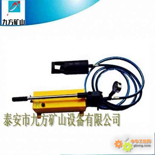

LMPÐÍҺѹÂÝĸÆÊÇÐÆ÷——
Ì©°²Êоŷ½¿óɽÉ豸ÓÐÏÞ¹«Ë¾Éú²úµÄÂÝÄ¸ÆÆÇÐÆ÷²ÉÓÃҺѹÉè¼ÆÑ¹Á¦´ó¡¢ÆÆÇÐÁ¦´ó¡¢ÄÍʹÓã¬ÂÝÄ¸ÆÆÇÐÆ÷ÓÃÓÚÌú·¡¢¿óɽ¡¢¹¤³ÌµÈÐÐÒµ£¬ÊÊÓÃÓÚú¿óÎåҺѹԴ·À±¬³¡ËùµÄÂÝÄ¸ÆÆÇÐ×÷Òµ¡£¸Ã²úÆ·¾ßÓÐÖØÁ¿Çá¡¢Á¦Á¿´ó¡¢Ê¹Ó÷½±ã¡¢¹¤×÷ЧÂʸߵÄÌØµã£¬¿ÉÒÔÆÊÇнôÌùÔÚê¸ËºÍÆ½ÃæÉϵÄÂÝĸ¡£Ö§»¤Ãª¸ËÌØÖÆÂÝĸÆÊÇÐЧ¹û·Ç·²¡£
¼¼ÊõÖ¸±ê£º1¡¢¶î¶¨ÆÊÇÐÁ¦£º 200-425KN£»   2¡¢¶î¶¨¹¤×÷ѹÁ¦£º63MPa£» 3¡¢ÆÊÇÐÂÝĸ·¶Î§£ºM20-80£» 4.ÊÖ¶¯ÒºÑ¹Ê½¡£
Ö÷Òª²ÎÊý£º
²ÎÊý/ÐͺÅ
LMP32-41
LMP41-50
LMP50-60
LMP60-70
LMP70-80
ÆÆÇÐÁ¦(KN)
265
300
340
380
425
ÆÆÇз¶Î§
M22-M27
M27-M33
M33-M39
M39-M45
M45-M52
¶î¶¨Ñ¹Á¦(MPA)
60
60
60
60
60
¹¤×÷½éÖÊ
32ҺѹÓÍ
32ҺѹÓÍ
32ҺѹÓÍ
32ҺѹÓÍ
32ҺѹÓÍ
¹¤×÷ÐгÌ(mm)
30
35
40
45
»ú    Á¿(kg)
15
16.5
18
24
30
