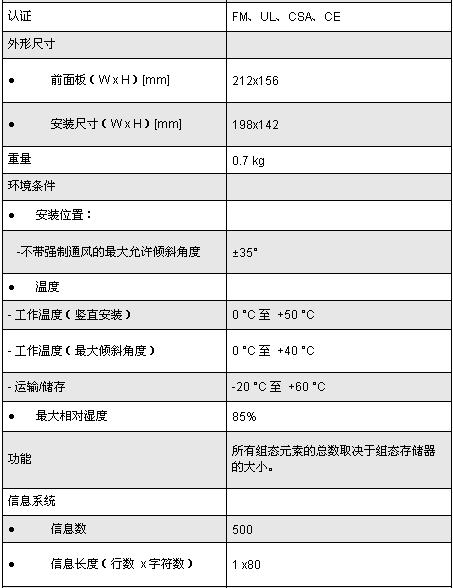

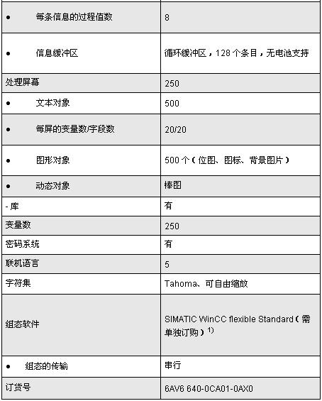

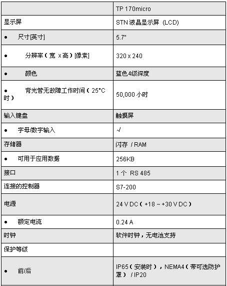

¼¼Êõ²ÎÊý£º
°´´ËÔÚд°¿Úä¯ÀÀͼƬ
°´´ËÔÚд°¿Úä¯ÀÀͼƬ
°´´ËÔÚд°¿Úä¯ÀÀͼƬ
1£©WinCC flexible Ö§³ÖµÂÓï/Ó¢ÓV1.0 ºÍ¸ü¸ß°æ±¾£©¼°·¨Óï/Òâ´óÀûÓï/Î÷°àÑÀÓV1.0 SP1 ºÍ¸ü¸ß°æ±¾£©¡£
