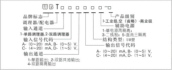

[ÐͺÅ˵Ã÷]
[µ÷ÀíÆ÷Ðͺż°²ÎÊý±í£¨±ê×¼Ìõ¼þϲâÊÔ£©]

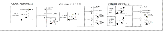

[µäÐͽÓÏßʾÀý]

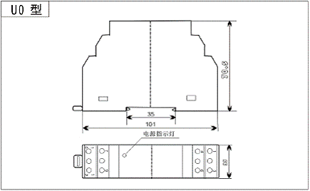

[½á¹¹³ß´ç]
