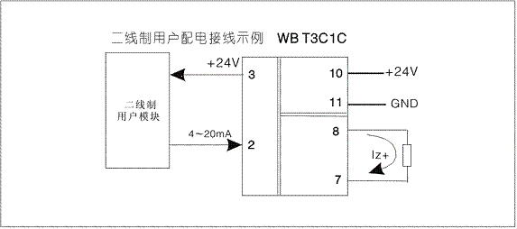

Ö§³Ö2ÏßÖÆºÍ3ÏßÖÆÊäÈ뷽ʽ£»
ÅäµçÊä³ö+24V£¬×î´óÅäµçµçÁ÷25mA£»
ÊäÈë/Êä³öÁ½¸ôÀë»òÊäÈë/Êä³ö/µçÔ´Èý¸ôÀë»òËùÓÐÊäÈë/ËùÓÐÊä³ö/µçÔ´È«¸ôÀ룻

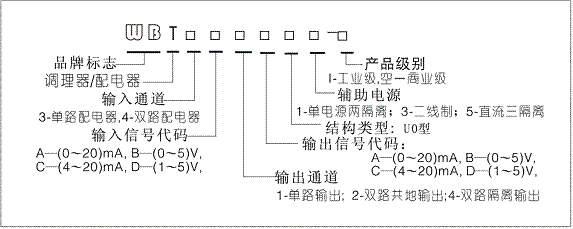

[ÐͺÅ˵Ã÷]
[ÅäµçÆ÷Ðͺż°²ÎÊý±í£¨±ê×¼Ìõ¼þϲâÊÔ£©]
²úÆ·ÐͺÅ
¹¦ÄÜÃèÊö
¾«¶ÈµÈ¼¶
Êä³ö±ê³ÆÖµ
ÏìӦʱ¼ä
×î´ó¸ºÔØÄÜÁ¦
ÎÂÆ¯(ppm/¡æ)
½á¹¹ÀàÐÍ
µçÔ´
²úÆ·¼¶±ð
WBT3C1BU05
1Èë1³ö£¬Èý¸ôÀë
0.2
5V
120mS
5mA
150
U0
+24V
¿Õ/I
WBT3C1CU05
1Èë1³ö£¬Èý¸ôÀë
0.2
(4-20)mA
120mS
300¦¸¡«500¦¸
250
WBT3C4CU05
1Èë2³ö£¬Èý¸ôÀë
0.5
(4-20)mA
150mS
300¦¸¡«500¦¸
250
