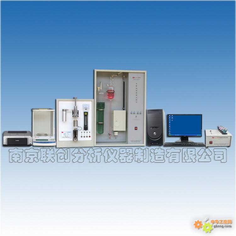

²úÆ·Ãû³Æ£º µçÄÔ¶àÔªËØÁª²â·ÖÎöÒÇ
ÐÍ ºÅ£º LC-8
LC-8Ð͵çÄÔ¶àÔªËØÁª²â·ÖÎöÒÇ
Ò»¡¢Ó¦ÓÃÁìÓò
ÊÊÓÃÓÚ¸ÖÌú¡¢Ò±½ð¡¢ÖýÔì¡¢»úе¡¢»¯¹¤¡¢¿óÒµ¡¢½¨Öþ¡¢»·±£µÈÐÐÒµºÍ¸ßµÈԺУ¡¢¿ÆÑÐÔºËù¼°ÖÊÁ¿¼à¶½²¿ÃŶԽðÊôºÍ·Ç½ðÊô²ÄÁÏÖеĶàÖÖÔªËØ½øÐж¨Á¿·ÖÎö²â¶¨
¶þ¡¢Ö÷Òª¹¦ÄÜÌØµã
1¡¢Ò»Ì×ÒÇÆ÷¿É¿ìËÙ¼ì²â¸ÖÌú¡¢ÓÐÉ«½ðÊôµÈ²ÄÁÏÖеÄËùÓг£¹æÔªËØÌ¼¡¢Áò¡¢ÃÌ¡¢Áס¢¹è¡¢¸õ¡¢Äø¡¢îâ¡¢·°¡¢îÑ¡¢ÂÁ¡¢Í­¡¢Ìú¡¢Îý¡¢Ð¿¡¢Ç¦¡¢Ï¡ÍÁ¡¢Ã¾¡¢îÜ¡¢ïÓ¡¢îé¡¢ïȵȺ¬Á¿
2¡¢Æ·ÅƵçÄÔ¿ØÖÆ¡¢²É¼¯¡¢´¦Àí¡¢±£´æºÍÊä³ö¼ì²âÊý¾Ý£¬19#Òº¾§ÏÔʾ²Ù×÷½çÃæ£¬Ì¨Ê½´òÓ¡»ú´òÓ¡²âÊÔ±¨¸æ£¬Óû§¿É°´ÐèÒªÉèÖüì²â±¨¸æ²ÎÊý
3¡¢ÒÇÆ÷µÄÁãµã¡¢Âú¶ÈÓɼÆËã»úʵʱ¼ì²â£¬×Ô¶¯µ÷Õû£¬Ïû³ýÈ˹¤·´¸´Ð£Õý²Ù×÷µÄÂé·³
4¡¢Íò·ÖÖ®Ò»µç×ÓÌìÆ½×¼È·³ÆÑù£¬Ìá¸ß¼ì²â¾«¶È£¬¾ßÓÐÁª»ú²»¶¨Á¿³ÆÑù¹¦ÄÜ£¬·½±ã¿ì½Ý
5¡¢²âÊÔ¹¦ÄÜÆëÈ«£¬¾ß±¸¼ì²â108¸öÒÔÉϲâÊÔͨµÀ¿Õ¼ä£¬¿É´¢´ænÌõ²âÊÔÇúÏß
Èý¡¢Ö÷Òª¼¼Êõ²ÎÊý
1¡¢·ÖÎö·½·¨£ºÆøÌåÈÝÁ¿·¨£¬µâÁ¿·¨£¬¹â¶È·¨
2¡¢²âÁ¿·¶Î§£º£¨ÒòÒÇÆ÷¿É¼ì²âµÄÔªËØ½Ï¶à£¬ÏÖÒÔ¸ÖÌúÖÐC¡¢S¡¢Mn¡¢P¡¢Si¡¢Cr¡¢NiµÈ³£¼ûÔªËØÎªÀý£©C£º0.010¡«6.000%£¬S£º0.0030¡«2.000%£¬Mn£º0.010¡«20.500%£¬P£º0.0005¡«1.0000%£¬Si£º0.010¡«18.000%£¬Cr£º0.010¡«38.000%£¬Ni£º0.010¡«48.000%£¬Mo£º0.010¡«7.00%£¬ΣRE£º0.0100¡«0.500%£¬Mg£º0.0100¡«0.800%£¬Cu£º0.010¡«8.000%£¬Ti£º0.010¡«5.000%(¸Ä±ä²âÊÔÌõ¼þ£¬·¶Î§¿ÉÏàÓ¦À©´ó)
3¡¢²âÁ¿¾«¶È£º·ûºÏGB/T223.69-2008£»GB/T223.68-1997£»GB223.3¡«5¡«1988¹ú¼Ò±ê×¼
4¡¢µç×ÓÌìÆ½£º³ÆÁ¿·¶Î§0-100g£»¶ÁÊý¾«¶È0. 1mg£¨Íò·ÖÖ®Ò»£©
5¡¢¼ÆËã»ú£ºÌ¨Ê½Ö÷Á÷Æ·ÅÆ»úÐÍ£¨¿É¸ù¾Ý¿Í»§ÒªÇóÅäÖã©
6¡¢µçÔ´µçѹ£º220V±10%  50Hz
ËÄ¡¢ÒÇÆ÷µÄ×é³É
1¡¢LC-8Ð͵çÄÔ¸ßËÙ̼Áò·ÖÎöÒÇ1̨
2¡¢LC-DL1Ð͵绡ȼÉÕ¯1̨
3¡¢LC-8Ð͵çÄÔ¶àÔªËØ·ÖÎöÒÇ1̨
4¡¢Íò·ÖÖ®Ò»µç×ÓÌìÆ½1̨
5¡¢¼ÆËã»úÖ÷»ú1̨
6¡¢Òº¾§ÏÔʾÆ÷1̨
7¡¢Ì¨Ê½ÅçÄ«´òÓ¡»ú1̨
8¡¢·ÖÎöÈí¼þ1Ì×
9¡¢ÑõÆø¼õѹÆ÷£¬×Ô¶¯¼ÓÒºÆ÷µÈÒÇÆ÷Åä¼þ1Ì×
ÒÇÆ÷ÖÆÔì³§¼Ò¸ºÔðÃâ·ÑÏÖ³¡°²×°µ÷ÊÔÒÇÆ÷£¬ÅàѵÒÇÆ÷²Ù×÷ÈËÔ±£¬Ð­Öú³ï½¨»¯ÑéÊÒ£¬Ìṩ»¯Ñ§·ÖÎö·½·¨ºÍ¹¤ÒյȶàÖֵļ¼ÊõÖ§³Ö£¬ÒÇÆ÷±£ÐÞÆÚÒ¼Ä꣬ÖÕÉíάÐÞ·þÎñ£¬»¶Ó­À´µç×Éѯ¡£
