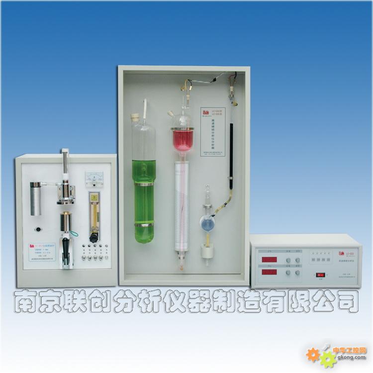

²úÆ·Ãû³Æ£º ̼Áò·ÖÎöÒÇ Î¢»ú̼ÁòÒÇ
ÐÍ ºÅ£º LC-CS3
LC-CS3Ð͸ßËÙ̼Áò·ÖÎöÒÇ
Ò»¡¢Ó¦ÓÃÁìÓò
ÊÊÓÃÓÚ¸ÖÌú¡¢Ò±½ð¡¢ÖýÔì¡¢»úе¡¢»¯¹¤¡¢¿óÒµ¡¢½¨Öþ¡¢»·±£µÈÐÐÒµºÍ¸ßµÈԺУ¡¢¿ÆÑÐÔºËù¼°ÖÊÁ¿¼à¶½²¿ÃŶԸÖÌú¼°ÆäºÏ½ðµÈ²ÄÁÏÖеÄ̼ÁòÁ½ÖÖÔªËØ½øÐж¨Á¿·ÖÎö²â¶¨
¶þ¡¢Ö÷Òª¹¦ÄÜÌØµã
1¡¢¾­µä·ÖÌåʽ½á¹¹Éè¼Æ£¬¿ØÖƺͷÖÎö×Ô³ÉÒ»Ì壬·½±ã²Ù×÷ά»¤
2¡¢ÆøÌåÈÝÁ¿·¨È«×Ô¶¯¶¨Ì¼£¬µâÁ¿·¨ÊÖ¹¤¿ØÖƶ¨Áò
3¡¢ÐÂÐÍ¿¹Ç§Èŵ¥Æ¬»ú¿ØÖƵç·£¬Ïû³ýÒý»¡Ç§ÈÅ£¬ÐÔÄÜÎȶ¨¿É¿¿
4¡¢¸ÖÌú¸ßµÍ̼ÏÔʾ·½Ê½ÉèÖ÷½±ã£¬Ö±¶Áº¬Á¿£¬ÎÞÐèϵÊý»»Ëã
5¡¢½ø¿Ú¾«ÃÜ´«¸ÐÆ÷¼ì²âÊý¾Ý£¬ÏßÐԺ㬲âÊÔ½á¹ûÎȶ¨¿É¿¿£¬²âÁ¿½á¹ûÊýÏÔÖ±¶Á
Èý¡¢Ö÷Òª¼¼Êõ²ÎÊý
1¡¢²âÁ¿·¶Î§£ºÌ¼£º0.010%¡«6.000%  Áò£º0.003%¡«2.000%
£¨¸Ä±ä²âÊÔÌõ¼þ£¬²âÁ¿·¶Î§¿ÉÏàÓ¦À©´ó£©
2¡¢²âÁ¿Ê±¼ä£ºÔ¼45Ã루²»º¬È¡Ñù¡¢³ÆÑùʱ¼ä£©
3¡¢²âÁ¿¾«¶È£º·ûºÏGB/T223.69-97¡¢GB/T223.68-97¹ú¼Ò±ê×¼
4¡¢µçÔ´µçѹ£º220V±10%  50Hz
5¡¢¶¯Á¦ÆøÌ壺ÑõÆø£¬Ñ¹Á¦0.02-0.04MPa
ËÄ¡¢ÒÇÆ÷µÄ×é³É
1¡¢LC-DL1Ð͵绡ȼÉÕ¯1̨
2¡¢LC-CS3Ð͸ßËÙ̼Áò·ÖÎöÒÇ·ÖÎöÏä1̨
3¡¢LC-CS3Ð͸ßËÙ̼Áò·ÖÎöÒdz̿ØÏä1̨
4¡¢YQY-6ÑõÆø¼õѹÆ÷£¬¹èîâ·Û£¬ÎýÁ£µÈÒÇÆ÷Åä¼þ1Ì×
¸ÃÒÇÆ÷²â̼ȫ×Ô¶¯£¬²âÁòÊÖ¹¤µÎ¶¨£¬ÊʺÏÖÐС¸ÖÌúÖýÔìÆóÒµµÄ¯ǰ·ÖÎö£¬³ÉÆ·¼ì²â¡£ÎÒ¹«Ë¾¸ºÔðÏÖ³¡Ãâ·Ñ°²×°µ÷ÊÔÒÇÆ÷£¬ÅàѵÒÇÆ÷²Ù×÷ÈËÔ±£¬Ð­Öú³ï½¨»¯ÑéÊÒ£¬Ìṩ¶àÖֵļ¼ÊõÖ§³Ö£¬ÒÇÆ÷±£ÐÞÒ»Ä꣬ÖÕÉíάÐÞ·þÎñ£¬»¶Ó­À´µç×Éѯ¡£
