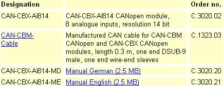

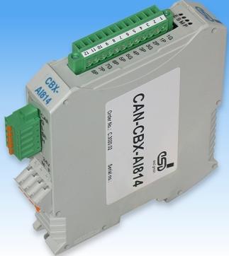

产品名称: CAN-CBX-AI814
型  号: CAN-CBX-AI814
价  格:
*CANopen module with In-Rail-Bus
*8 A/D-converter inputs
*resolution 14 bit
*input voltage range ?0.24 V
*sample rate up to 100 祍/ 8 channels simultaneously
*electrical isolation of analogue inputs
*replacing individual modules from InRailBus without interrupting CAN or power feed
*CAN/CANopen interface electrically isolated and designed acc. to ISO 11898
*ambient temperature range -20 癈 ... +70 癈
*firmware adaptable to customers'''''''' requirements and upgradeable via CANopen
*CANopen profiles DS-301, DS-401
