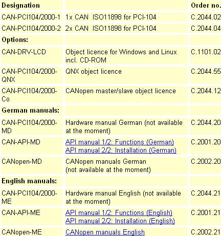

PC104\PC104+接口的CAN通讯卡,含1至4个CAN口,支持CANopen和DEVICENET协议,智能卡和非智能卡,提供丰富的函数库和软件
详细介绍
*interface from PCI-104 to one or two independent CAN nets
*local data management by FPGA
*CAN data supported to PCI via Dual Port RAM
*CAN controller in FPGA supports ISO11898-1 (CAN2.0)
*CAN interfaces electrically isolated and designed acc. to ISO 11898-2 (bit rate up to 1 Mbit/s)
*software drivers available for many operating systems
*CANopen master-slave object licence available
