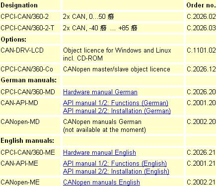

*2 independent CAN nets
*high end microcontroller 68360, 25 MHz, 32 bit
*128 k x 32 Fast SRAM, 1 M x 8 Flash EPROM
*CAN controller SJA1000, CAN 2.0A/B
*differential CAN interface, electrical isolation, 1 Mbit/s, ISO11898
*ambient temperature range 0...50 °C or extended temperature option -40 °C ... +85 °C
*software for Windows 95/98/NT/2000 and other operating systems available
