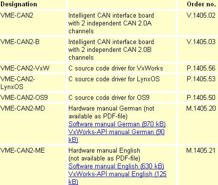

VME接口的CAN通讯卡,含1至4个CAN口,支持CANopen和DEVICENET协议,提供丰富的函数库和软件
详细介绍
*full CAN controller by integrated firmware for any identifier
*Basic CAN controller 82C200 or Full CAN controller 82527
*electrical isolation by optocouplers
*ISO 11898 CAN layer
*data transfer rate up to 1 Mbit/s
*CPU 68000, 20 MHz
*512 kbytes battery-backed SRAM with CRC check and 1 Mbyte EPROM
*VMEbus compatibility: IEEE 1014 / C.1
*VMEbus access: SADO32, SD16
*CAN protocol support:
-CAL/CMS and CANopen
-DeviceNet
*Higher layer protocols as CAL, CANopen and DeviceNet for VMEbus master CPU and various operating systems available
