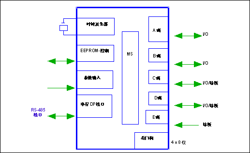

(5) LSPM2½á¹¹Í¼, ¼ûͼ5-1¡£
(6) Ó¦ÓÃLSPM2µÄPROFIBUS-DP´ÓÕ¾½Ó¿Ú¿òͼ£¬¼ûͼ5-2¡£
 ASIC LSPM 2 ·½¿éͼ
