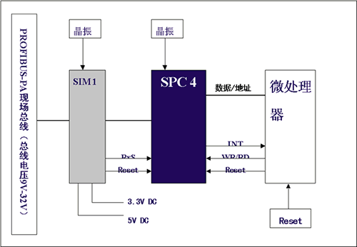

£¨1£© ÓÃ;£º
     ÓÃÓÚ´ÓÕ¾µÄÖÇÄÜͨÐÅоƬ£¬ SPC 4 »¹ÌṩÁËÁ¬½ÓSIM 1µÄͬ²½½Ó¿Ú£¬Êý¾Ý´«Êä·ûºÏIEC 1158-2£¬ÓÃÓÚPROFIBUS-PAµ¥Ôª¡£ÓÉÓÚ¸ÃоƬ¾ßÓе͹¦ºÄ¹ÜÀíϵͳ£¬Òò´ËÌØ±ðÊʺÏÓÃÓÚ±¾Õ÷°²È«³¡ºÏ¡£ SPC4ʹÓôø¸ôÀëµÄRS-485Çý¶¯Ò²¿ÉÓÃÓÚPROFIBUS-DP´ÓÕ¾µÄÁ¬½Ó¡£
£¨2£©¼¼ÊõÖ¸±ê£º
¨‹×î´óÊý¾Ý´«ÊäËÙÂÊ12Mbit/s£¬Ê¹ÓÃIEC1158-2¼¼ÊõʱÊý¾Ý´«ÊäËÙÂÊ31.25Kbit/s£¬¿É×Ô¶¯¼ì²â²¢µ÷ÕûÊý¾Ý´«ÊäËÙÂÊ¡£
¨‹ ¾ßÓÐ1.5KbyteµÄÐÅÏ¢±¨ÎÄ´æ´¢Æ÷¡£
¨‹44¹Ü½ÅµÄPQFP·â×°¡£
¨‹Ö§³ÖPROFIBUS-DP¡¢PROFIBUS-FMSЭÒé¡£
¨‹Óë80C32¡¢80X86¡¢80C166¡¢80C165¡¢80C167ºÍHC11¡¢HC16¡¢HC916ϵÁÐоƬ¼æÈÝ¡£
¨‹ 5V»ò3.3VDC¹©µç,µÍ¹¦ºÄ¡£
